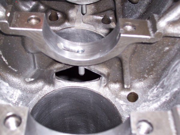

Steve Broughton (Of SBD) has told my mate that if you run oil sprayers you can't keep enough oil pressure. Talk to SBD! The suggested way is to drill a tiny hole in the rod? I've seen a rod done (might of been from an F1 car).
Nic Barnes
26th Jul 05 at 17:33   View User's Profile U2U Member Reply With Quote
reckon i know what you mean. them steel rods ive got have something done to em apparantly. its just the home made eds phase 4 engine that i got. them spray bars only release right up top revs i belive. ball bearing in the end of em so they arent going all the time. only when oil pressure is right up.
well, will see how long it lasts, lol. that daredevil nova thing from germany or some other foreign land and the 600+bhp white nova thing has em. will let ya know probably tomorrow when i get the car fired up if i have oil pressure or not. if not, cost a fw quid to fix, lol. doh
timrud_
Registered: 3rd Jul 04
Location: Sheffield
26th Jul 05 at 17:41   View User's Profile U2U Member Reply With Quote
think it will just give you slightly lower oil pressure, but not sure by how much. Would dry sumping solve it or not? Am I barking up the wrong tree lol
BeArDy
Registered: 7th Aug 00
26th Jul 05 at 17:43   View User's Profile U2U Member Reply With Quote
you can turn the oil pump up so runs slightly more presure if you run oil spray bars.
heres a pics of the ones i will be running
BeArDy
26th Jul 05 at 17:44   View User's Profile U2U Member Reply With Quote
-oil spray bars are to cool the underside of your pistons
-Dry sump is so you can rev high and not have the top of the engine flud with oil
Nic Barnes
26th Jul 05 at 17:52   View User's Profile U2U Member Reply With Quote
beardy - same kinda shit i got in mine, hole in bearing for the spray nozzle etc.
only went for em as i melted 3 pistons last time, so like tesco's, every little helps
