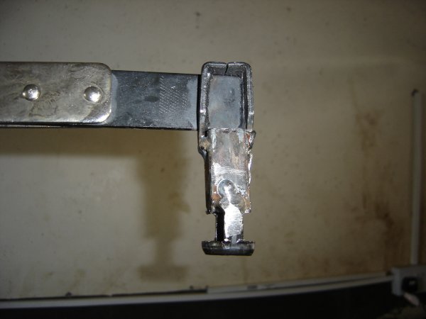

Taking valves out isn't as hard as I thought it would be. Needed to modify my valve spring thingie though...

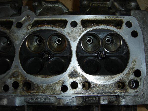

Also, anyone know of any good de-greaser, or are there people who will clean the head out for me, it's already been ported too
Also, the hexaust valves are caked in crap, whats the best way to sort them out?

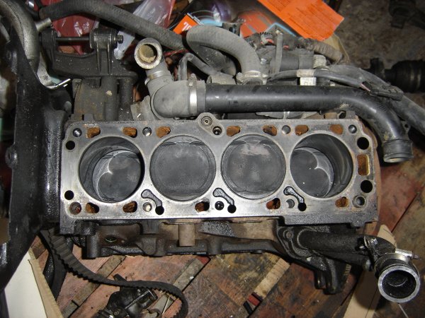

Oh, and I need to clean my pistons too

look on topbuzz or max boost
think you stick the valves in a drill and hold fine sandpaper against the shaft.
leave the seat area well alone though
stick the head in the dishwasher.

if your putting the same valves back in its best to keep them in order mate.
also a wire brush or some fine wet and dry will clean the valves

wire attachment on drill will clean pistons and valves mate,
keep it all in order as well

I tried taking the valves out of my c20xe with a standard spring compressor but had the same problem! wasn't long enough. Can you buy ones that are? or do you have to modify them? don't spose you fancy hiring it out?!?! lol, seriously.
Corsa C Z20Let
Black Sleeper Turbo Project
18th Apr 05 at 18:14   View User's Profile U2U Member Reply With Quote
You can buy them with longer bits on them. I thought that one would do, but I had to get my trusty welder onto it

I used brake and clutch cleaner fluid as you can buy it in gallon drums, and use a PLASTIC brush, it's very soft alloy and you dont' really want to scratch it any mor ethan you have to.
for the head mating surface, chamber and piston tops (although the last one is pointless) scotchbrite pads and WD40
