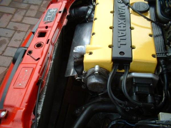

Adam B's bay.....
Distributor cap area......
mine
same area..why the difference? or is it just age of engine..
mines a 93 Cav item

hmm, strange one that, my engines from a 93 cav gsi and it is the same as adam b's

some had a dizzy some had a coil pack
13th Feb 05 at 19:53   View User's Profile U2U Member Reply With Quote
Right so it's not a botched thing........

coil pack engines aka dizzyless.
dunno why they changed. there must be an advantage to the coil pack.
13th Feb 05 at 19:55   View User's Profile U2U Member Reply With Quote
Bought a haynes will read it...on the coil pack..........
so mines is dizzyless?

more reliable and better control over ignition timing

am i right in thinking the 20xe was distrubutor and the c20xe was coil pack??

think they changed in 92/93, so c20xe's have dizzy too.
mine does.
13th Feb 05 at 20:19   View User's Profile U2U Member Reply With Quote
no, C20XE just means cat. IIRC the DIS XEs also have different cambelt + tensioners

Probably a very late C20XE, 92/93 onwards, although its not impossible to put a DIS pack on an earlyer dizzy XE
13th Feb 05 at 20:53   View User's Profile U2U Member Reply With Quote
so mine is the coil pack one yeah?

yup

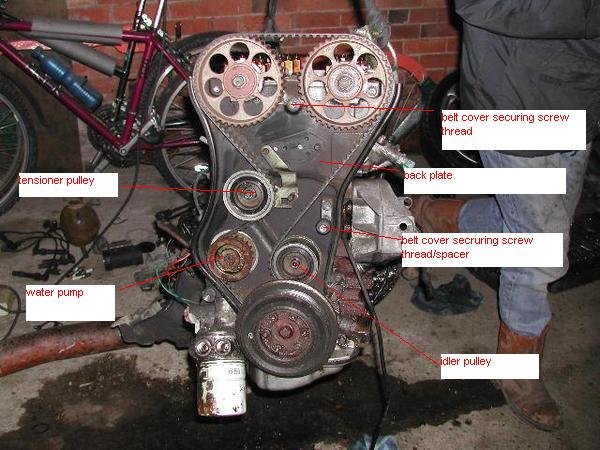

to get a more reliable idea of age have a look at the cambelt, i'll find a pic...

early type upto about 92 with Dizzy, same as mine

you can tell just by the shape of the belt cover.
later ones had a more protrusive shape around the idler.
also early have round toothed belts, late have square toothed.
