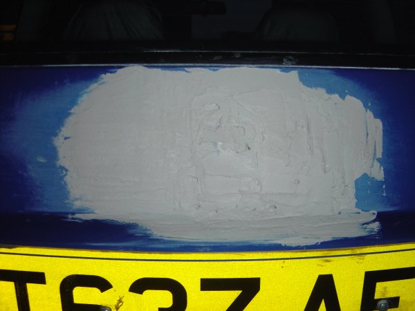

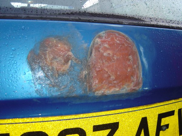

rather pay lots of silly money to get this done thought id have a go myself, never done anything like this so im hopeing all goes well heres a pic of from what i started last night...

just a bit of advice mate. u should of taken more paint off really
FlamingCorsa
Registered: 22nd Apr 03
Location: Shropshire
2nd Feb 05 at 08:47   View User's Profile U2U Member Reply With Quote
looks good may have been betta if u had got plates of metal welded in so it dont crack latter but it should be ok!
keep up the good work tho, well done having a go your self!
Wayne
Registered: 19th May 04
2nd Feb 05 at 08:50   View User's Profile U2U Member Reply With Quote
i sanded down 2 the metal on the boot lock and around the wiper hole but as u can see got abit messy as its not the easyiest stuff to work with lol, i need 2 sand the fibreglass down now and just add bodyfiller is this correct? cheers

did u use any mesh etc? did my wiper a while back
is good fun to do, i enjoyed it
Wayne
2nd Feb 05 at 09:20   View User's Profile U2U Member Reply With Quote
yeah i used mesh on both of them, bit fiddly to get fibreglass in that small space at bak of wiper, yeah im enjoyin it doin something myself and not havin 2 pay stupid money for it, ill take more paint off 2nite around the areas thanks for the advise lads much appreciated

the paint will come off when u sand it smooth and level anyway
got a large ish sanding block?
Wayne
2nd Feb 05 at 09:29   View User's Profile U2U Member Reply With Quote
got a sanding block somwhere but im thinkin of gettin a b&d mouse? only £23 wud be quicker and less effort

Loks ok so far, how deep was the recess for the bootlock???
Wayne
2nd Feb 05 at 09:35   View User's Profile U2U Member Reply With Quote
not that far really, stuck abit of mesh in the triangle and slapped fibre glass on both sides and its rock solid now

well i need 2 smooth it all off and add bodyfiller b4 priming then painting it

btw p40s a bitch to sand -use an angle grinder to get it relatively smooth and just belwo the surface - then a skim of p38 easy sand to finish

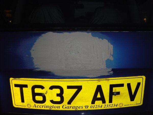

bought a mouse sander 2day from b&q done the job great ill post some pics in a min, just uploading

2nd Feb 05 at 17:43   View Garage View User's Profile U2U Member Reply With Quote
loooots to rub down
good job
Wayne
2nd Feb 05 at 17:44   View User's Profile U2U Member Reply With Quote
not that thick really and with a mouse sander doesnt take long
