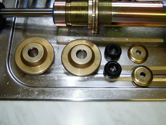

Just finished cleaning my FK coilovers, as when they were taken off the SXi they were very dirty!
After seeing a post on corsasport not so long ago about them snapping i thought i may as well spend 15 mins just cleaning them up!
When they were removed from the SXi, the garage just basically chucked everything in the box. Im now a little confused on what a few parts do!!
The front struts were basically set up as they should be, and the backs i kind of remember, however i have now 6 parts remaining and im not sure where they go!
The parts at the bottom of this pic, the two larage round shapes, 2 small round shapes and the two rubber bungs...

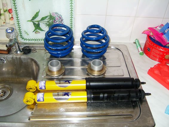

Here are the fronts
the rears
Can anyone help??

The extra parts go at the top of the assembly. You will need to fit the spring, then the small metal washer, then the rubber bush and then the top aluminium plate, this will all then be bolted to the car
