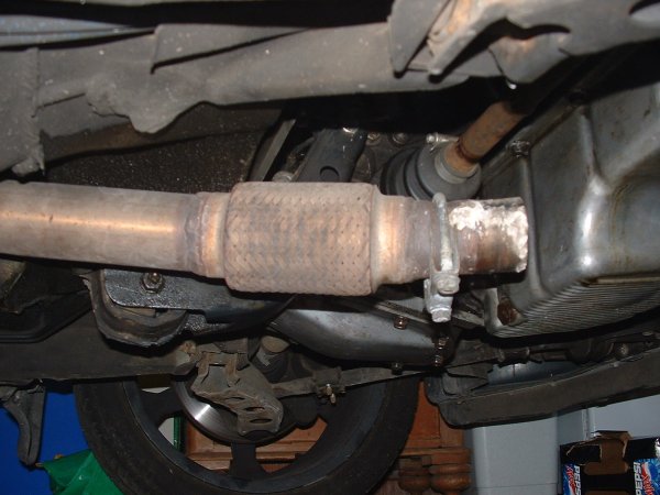

3rd Sep 04 at 23:16   View User's Profile U2U Member Reply With Quote
mine goes onto this littel flexi section thing, never had any problems with it blowing off-
[Edited on 03-09-2004 by Adam_B]

3rd Sep 04 at 23:26   View User's Profile U2U Member Reply With Quote
Hmmm that looks like a good option Adam, my system is solid all the way down from the manifold to the back box the only thing though is that the flexi section looks like its welded into the centre section pipe and isnt availible on its own, or is it????

4th Sep 04 at 10:24   View User's Profile U2U Member Reply With Quote
dunno mate, got it done at powerflow

SportBoy
Registered: 5th Oct 01
4th Sep 04 at 14:18   View User's Profile U2U Member Reply With Quote
use the flexi as in the pic alot better .. you can snap the manifold if you dont
