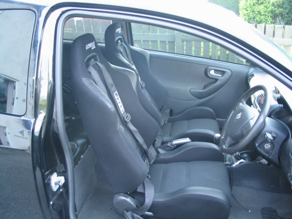

Well here they are. i must say a big thanks to Gaz for getting these here beofre trax

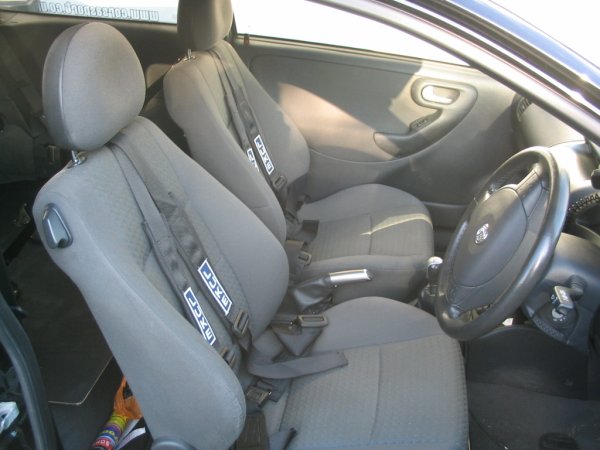

Before (normal seats and harnesses)
After (Corbeau Targa's and harnesses)

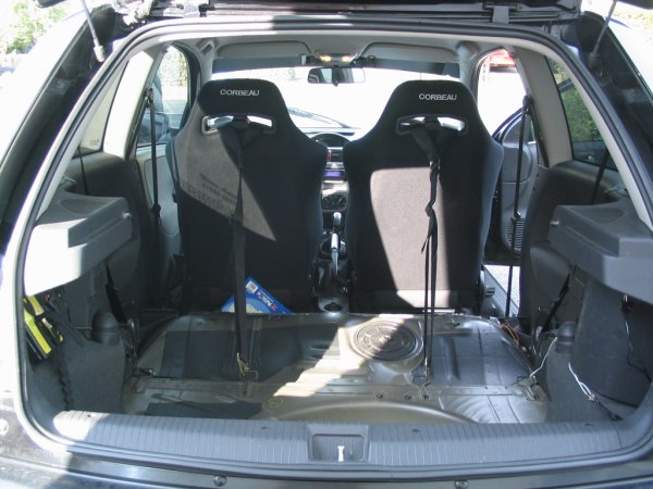

and a rear shot.

are those brackets wot the harnesses r clipped on strong enough - they dont look it but then again i aint seen them on a corsa c, jus know mine bolt through with those eye hooks

yea they are strong enough.. i hope

yeh you'll find out when your head hits the windscreen

i would move the harnesses off them brackets mate they will snap straight off if you have crash.

were should i bolt them m8?

they aint strong enuf!!!!!!

chris do u have holes where the buckle went from your old seatbelts? get some eye hooks and put them in there if so or to rear quarter pillars

Can you not put the ends of the harnesses through the standard rear seat belt bolt holes and use the original big torx bolts?

are them harneses the clip type
if so get the proper bolt in eylets and bolt them to where the rear seat belt botlted

i would maove where they are attached to straight away, or ure fuked in a crash

im gunna have a look at moving them 2day.
