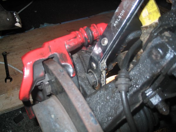

chris_uk
Registered: 8th Jul 03
30th Apr 04 at 20:24   View Garage View User's Profile U2U Member Reply With Quote
fucking pain to be honest.. was a right faff!
the bolt here was a tough cookie to crack!
You took off the wrong bolt, you're supposed to undo the 2 that are attatched to the caliper, they are smaller than them bolts.
chris_uk
30th Apr 04 at 20:36   View Garage View User's Profile U2U Member Reply With Quote
oops o well still worked
Edtrix_GSI16V
Registered: 3rd Sep 03
Location: Sheffield,South Yorkshire
30th Apr 04 at 22:34   View User's Profile U2U Member Reply With Quote
Get some decent tools might make the job far easier because rolson are poo

R Lee
Registered: 15th Aug 03
4th May 04 at 17:11   View User's Profile U2U Member Reply With Quote
had a go at the brakes today. the two bolts are correct. you have to take them off otherwise the caliper can't come off. and you need the calipers off or you can't get the disc off. pain in the arse because that bolt is fucking hard! couldn't manage it so had to put calipers back together again. round 2 tomo when i come back with better tools.
