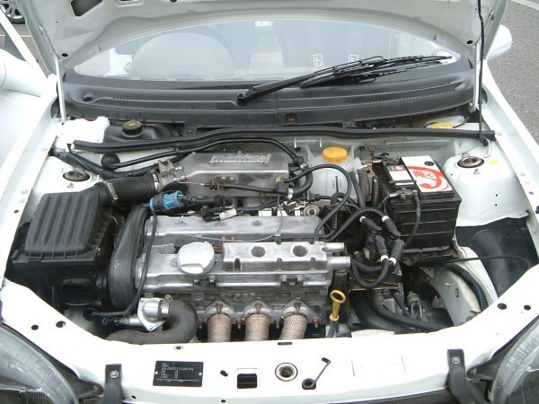

This is my first post, i have just joined after buying a 1.4 16v Sport and was wondering what are the best ways to tune the engine? What will give me the most performance gains?

Drilled air box with panel filter
Velos torque tube
Looking at a 15-18 bhp increase there for £500

My mate left me his pipercross induction kit on it i forgot 2 mention that. Ive heard that the manifold restricts the engine alot?

would compliment the torque tube etc with a decat as well! and manifold if u can afford it. another 7+ bhp for 200 notes

drill the airbox and fit a decent panel filter like k&n or pvd 1, good quality stainless exhaust system!! Then after that if you still have the cash a mantzel or velos torque tube and unichip with a decent rolling road set-up!! Jobs a good 'un!! Or get NoS

a velos or manzel will give u 20ish bhp extra, velos is cheaper. then get a de-cat and exhaust, drill air box or get a viper type filter, then get it set up with a uni chip.

basically the standard inlet on the 16v engine is really restricted, so fitting a new inlet(there are two types velos, will remove this restriction, hence more air=more power the lexmaul is the other type it keeps the restriction but it creates a ram type induction force giving u more power, the lexmaul is a direct swop for the top manifold. if your going to mod ur engine any more the first thing you should do is fit a new inlet maniofld to de-restrict the engine in a way! a uni chip is £400 fitted from velos. look on their web site http://www.velosmotorsport.co.uk

Looks like either viper induction, velos torque tube and unichip or maybe look at velos's 1.4 16v turbo converstion when it comes out. On there website they have been gettin 175bhp on there prototype. .

personally i would do:
pannel filter & drill air box
full exhaust system and decat
stainless steel exhaust manifold
ported flowed head
set of cams
Mantzel box
unichip and raise rev limit to 7250rpm
maybe a lightened fly wheel too could be good
if funds are no object get some thrtottle bodies
alternatively you coulod look at JR's stripped out 1.4 16v with 136bhp
that has:
264shrieck cams
Mantzel box
ported and gas flowed head
SBD exhaust manifold
uprated valve caps and springs
pocketed pistons
piper venier pulleys
Omex ECU
paneel filter
BFO exhaust
and more to come
i've driven this and got to say i was impressed, they still lack torque but once u get it buzzing it pulls really well...almost like my 2ltr

my spec:
SBD performance manifold
264 degree shrieck cams
Uprated valve springs and caps
Pocketed pistons
Mantzel powerbox
Omex ecu
7500 rev limit
ap racing 4 paddle clutch
decat, arp conrod bolts,
Full BFO system,
ported, polished and flowed head
quick shift
