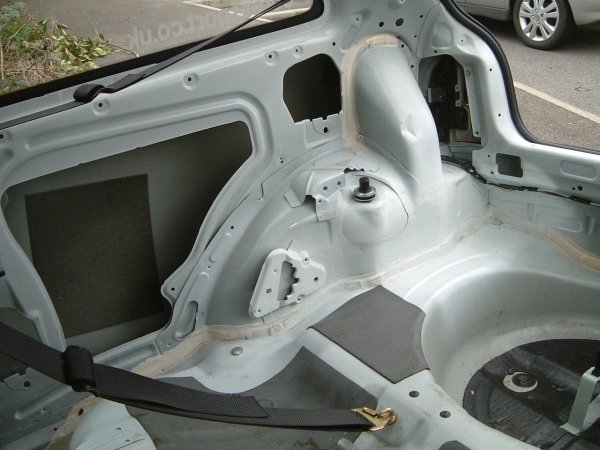

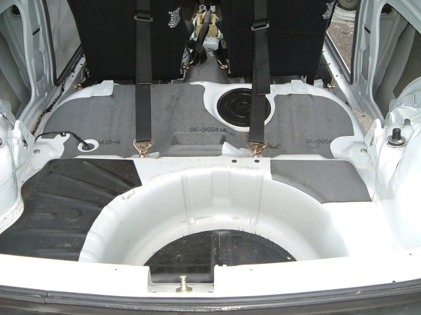

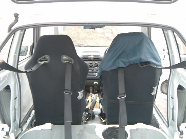

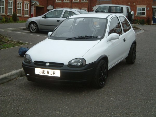

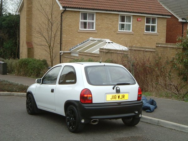

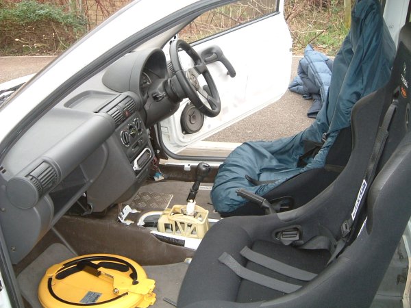

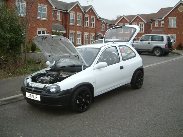

Here are some pics of JR's stripped out 1.4 16v conversion which was done by lee Mitchell and is a very tidy job.
Got to say i was amazed by how quick it was twas very brisk specially as its all stripped out, mid range is quite similar to my 2 litre i am very impressed. Had a little drive of it and it blows the socks off my old 1.4 16v Roll on the tb's james
and if anyone says it needs lowering its already lowered 40mm on koni ajustables it jst lacks an interior, and it handles the nuts
top job

Looks like a tidy job, i like the sxi wheels as well they look good. nice work

I still see a dash, some carpet, sound-proofing mats...
Still
micra_pete
Registered: 23rd Apr 03
12th Feb 04 at 13:06   View Garage View User's Profile U2U Member Reply With Quote
very nice that
Fad
Registered: 1st Feb 01
12th Feb 04 at 13:08   View User's Profile U2U Member Reply With Quote
Still
trust me it'll all be gone very soon dash is staying as it needs to look tidy. Plus its only a basic dash too If you look closely its very clean all the interior has been polished up nicely roof lining has also been removed

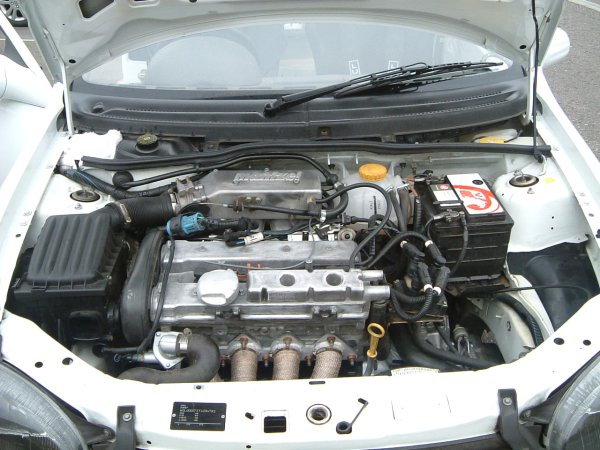

whats he done to gain 50bhp?
Fad
12th Feb 04 at 13:14   View User's Profile U2U Member Reply With Quote

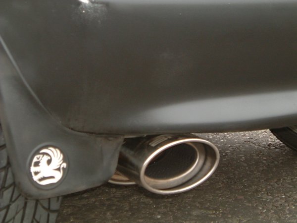

erm off the top of my head:
Shrick 264 cams ( i think)
ported polished flowed head
mantzel box
pocketed pistons
omex ECU
full BFO exhaust
Pannel filter
de cat
ARP conrod bolts
SBD exhaust manifold
and soon to TB's i am lead to belive
few other things i have missed i am sure James shall be online later to clarify it

Looks good, real sleeper, will be good when on tb's be well over 160 bhp then won't it with those cams, and pocketed pistons etc?

the interior needs to be carpeted. wpuld look mucho better then. coour coded bumpers would go down well too. has he had the ECU remapped yet?

must have been properly mapped to be getting that figure surely?
TB's could see him over the 160 mark i suppose... could he bore the 14xe block out some maybe

no the ecu is still set for when matt had the engine
lee mitchell
Registered: 26th Jan 01
12th Feb 04 at 13:46   View User's Profile U2U Member Reply With Quote
he could bore the block. but then he needs new pistons which where expensive. he could just put a 1.6 bottom end to get the figure a bit higher

12th Feb 04 at 13:52   View User's Profile U2U Member Reply With Quote
He messed with a 1.6 bottom end himself didn't he?

12th Feb 04 at 14:11   View User's Profile U2U Member Reply With Quote
looks good james.
it has an omex ecu and has been fully mapped on an engine dyno.
i think it may be a little less than the 136 bhp with the standard air box though
james if your gonna make it into a 1.6 i got the pistons, crank and block sitting in my garage.
oh yeah the rev limit is still set to 7500, can be put up to 8000 rpm if you like.
the peak power was 7033 rpm, i only lowered the rev limit cus i wanted to be more on the safe side.

12th Feb 04 at 14:12   View User's Profile U2U Member Reply With Quote
the torque would be alot better with the 1.6 bottom end. is only 107lb/ft at the moment

12th Feb 04 at 14:17   View User's Profile U2U Member Reply With Quote
out of interest, i noticed you got the cam cover on. are the vernier pulleys rubbing on it?
