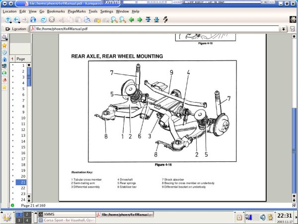

Only found like a schematic drawin of the rear suspension layout & transfer box so far, thats all (I'll post it up in a mo if anyone else is interested)

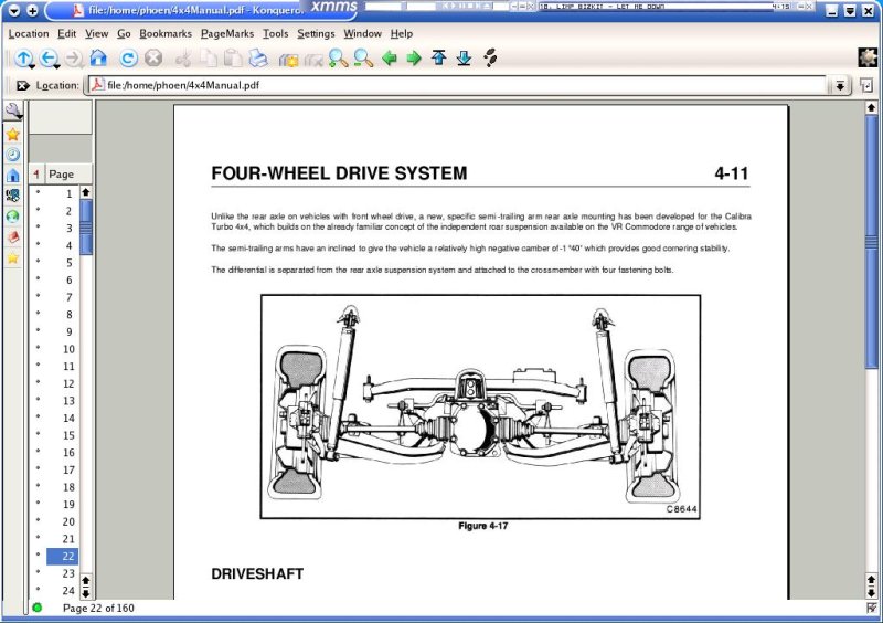

Ok well these are just a few shots from the 10MB doc i downloaded which took me the best part of 2 mins to get...
The first 2 images are the rear transfer box & all the suspension layout, etc, just schematics really
But there are no schematics or drawings of the actual cally or cav turbo car with the 4x4 drive system, instead its all diagrams of other cars or just examples drawn up
The doc I downloaded was supposed to be specific to the LET & also the 4x4 drive system on the Cally/Cav tubs, but instead, the drawings I needed are of other cars but the rest of the info on the engine & diagnostics/fault finding & codes is spot on

plus its all LHD in the doc aswell, no RHD details
