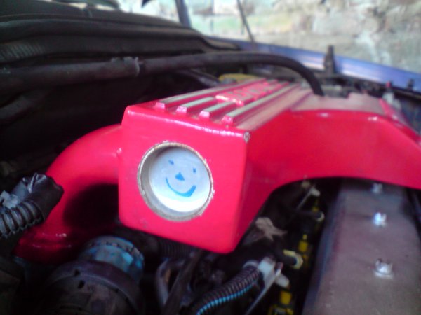

Ah right, you've got me thinking now.. I was going to leave the standard inlet on tbh but I am tempted by one of these. On their website they're around 350 all in which isn't too bad, as you said they fetch a good price second hand when they rarely crop up.

Mine is currently on Haimsey's car, and he re-painted it black. It's been through about 7 members on CS, but we had it as a set with the engine cover and strut brace which were all designed to fit perfectly with one another.

Is this the one with a smiley face inked on it somewhere? Sure I've read something somewhere about this manifold lol

No idea what you mean....
