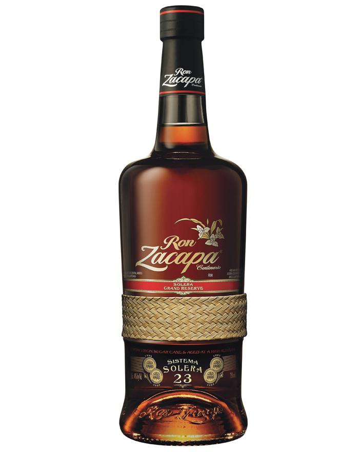

Check out the beautiful soft reflections in a shot like this:
http://www.whisky.dk/images/ron_zacapa_23_solera_700-p.jpg
While I like the background effect, I dislike that you've mirrored it for each shot. If you need to fill it out in post, clone something from a different photo.
The bottom one especially looks a bit like a blot-test with the obvious mirroring.
If you insist on having the reflection I think a black surface would work better than the mirror, to achieve a more toned down look. Personally I'd also prefer a slightly diffused reflection, but I guess that's a matter of taste.
