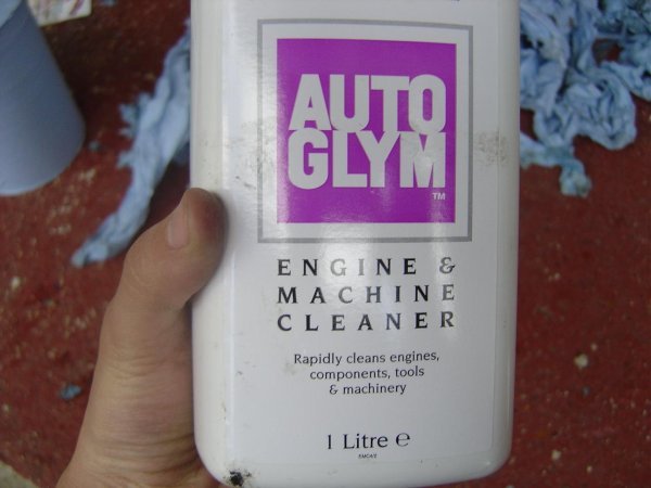

Next up, I laid all the parts of the coilover down on my garage floor, and started cleaning all the parts off using Autoglym Engine and Machine Cleaner - Good Stuff!
Once they were all cleaned off with blue paper and degreaser, it looked like this:
