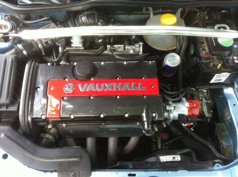

A couple of photos from Trax on sunday:

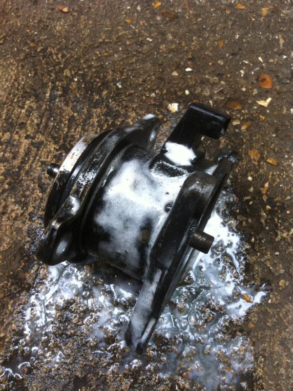

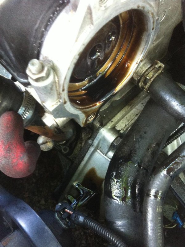

Well, last week the car was juddering around at 2K revs and making it sound like it was losing power to the spark and also misfiring.
I thought it was coil related and wiring again but there wasn't any signs in that so I tried to make it do it to get the EML on which eventually happened.
I then flashed the fault up on the EML and got the code for Hall Effect Sensor (low voltage)
So decided I'd try a new distributor first.
Picked one up last night off of SteveoBC along with a new rocker cover
So here's a few photos to stop boring you all with words

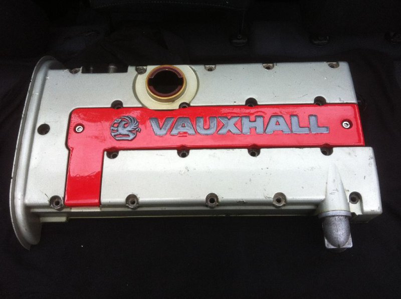

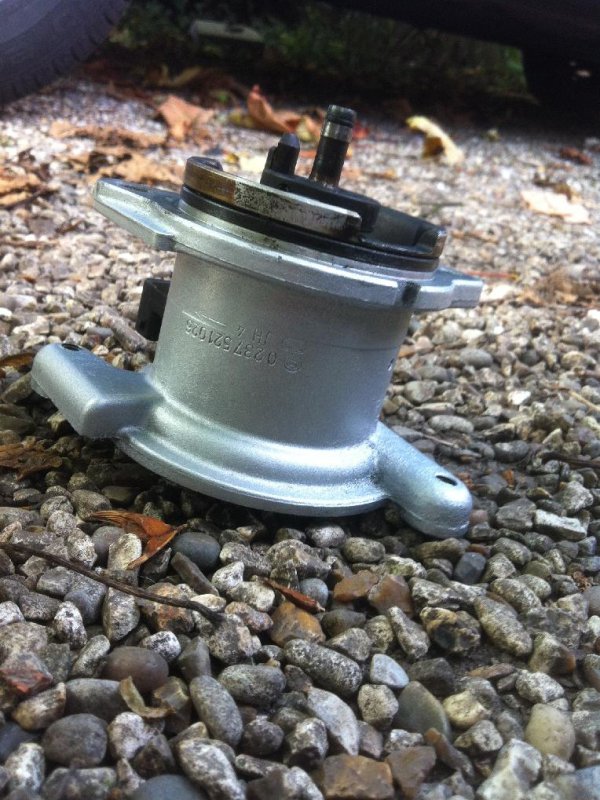

Degreased the new Dizzy:
Then sprayed it up.
Took the old one out and obviously the new seal was working as it got oil everywhere
Fitted
and then a photo of the new rocker:
That'll be getting sprayed WELL this time
Thanks to Steve for the bits.

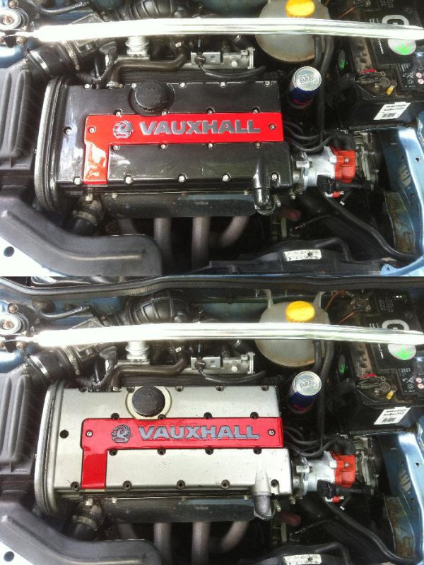

opinions people:

Think it's staying anthracite, just keep thinking it would look brighter silver
