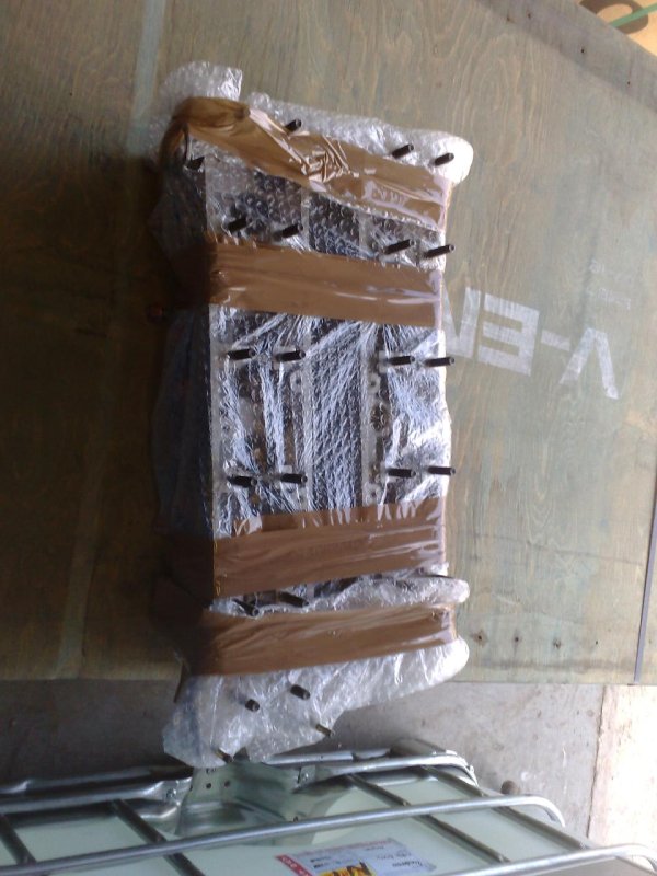

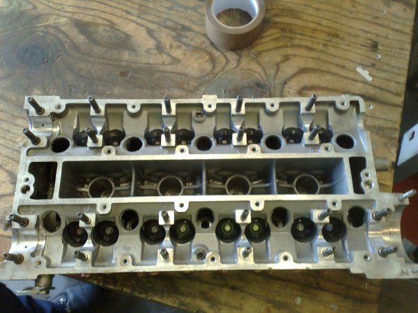

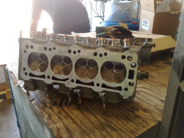

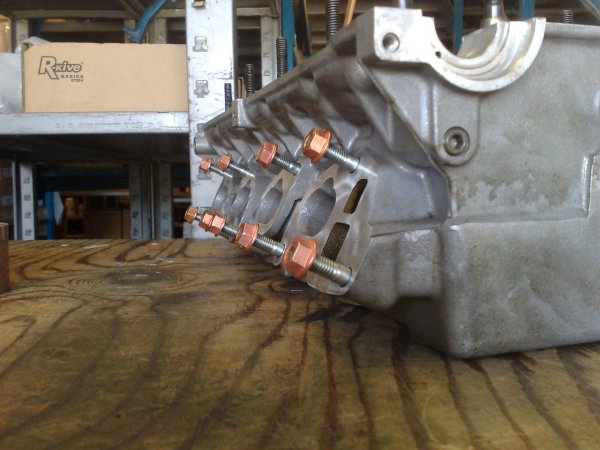

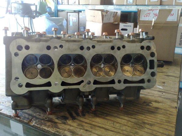

Update:
Well finally, ive had time to finish the head off.
All 16 valves lapped in, new stem seals, 32 new valve springs, 16 new spring caps all fitted.
Then leak tested the ports with petrol to check no leaks. When i did this, i found no 1 exhaust valve to be leaking like a sieve. This was then removed, and found to be cracked very slightly. So in went a spare valve.
Then in went 23 new exhaust/inlet studs and copper nuts.
The heads been fully cleaned up now and packaged up in bubble wrap to keep it clean
