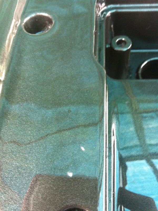

I got the rocker cover sprayed which came out great:
Only to find out where I had fixed the TPS I had leant on it and ruined it from where the lacquer hadn't hardened enough.
Completely my fault so set about friday re-spraying that and sanding it down.

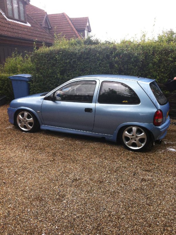

So then I got it all rinsed off inbetween rain showers and cleaned it up for billing:

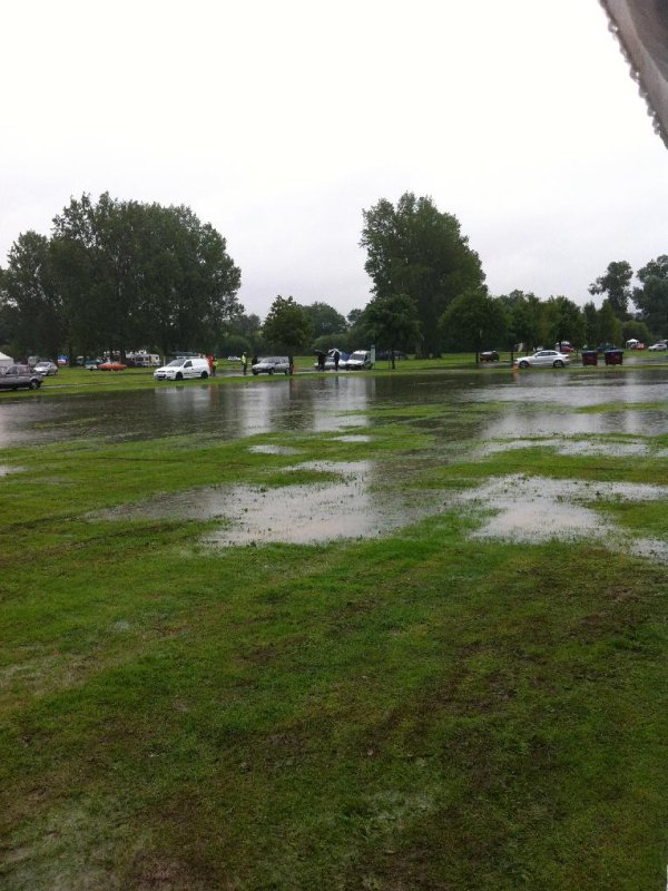

Arrived to be greated with this:
Yup. Billing was cancelled!
So I was pretty gutted. I'd spent two days getting it ready and it didn't even go on show.

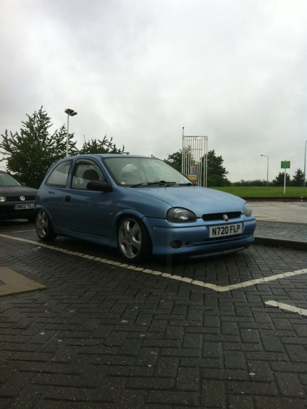

So got a final picture of it at the services on the way home:
All in all a bit annoyed but you can't help the weather! I'm happy it's running good again I just want to get the emissions checked again monday then I'm a happy bunny!
