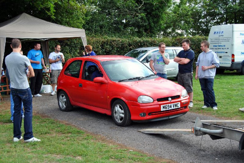

It runs. Still needs a water pipe attaching, but it drove onto the trailer under it's own steam

We are on the way to combe now. Corsa is on the trailer. We went to fill it with water and it pissed out the back. Left one of the water pipes off the inlet manifold
Going to sort that in the morning then fit a gasket to the exhaust and she's good to go.

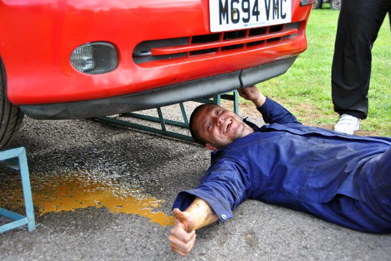

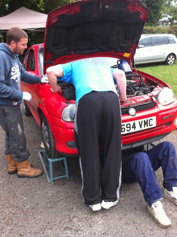

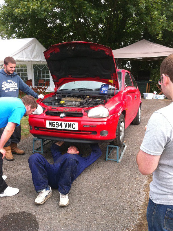

Full story from the weekend, roughly in order, thanks to everyone who got the pics -
Unload
On the ramps for the hose fix. Which was not the easiest job. Had to remove the hose completely so that it wasn't in the way to get it on the head, then re-attach to the other pipe after that.
And a lap!
Started smoking shortly after that, either fluids left-over from the rebuild or HG has failed because I didn't torque the head properly. It also wasn't honed and we re-used the old rings just to get it going. Going to try and get it over to philip2 this week for a hone and I'll buy rings as well, perhaps a new HG to be safe.
There's also a wobble on the steering under braking which needs investigating. It's had brakes recently which may indicate that it's some more serious although I don't know if the discs were changed. I've got 236mm discs and pads off the white one which I may use as I'll probably upgrade those when that goes back together.
Fun fun.
