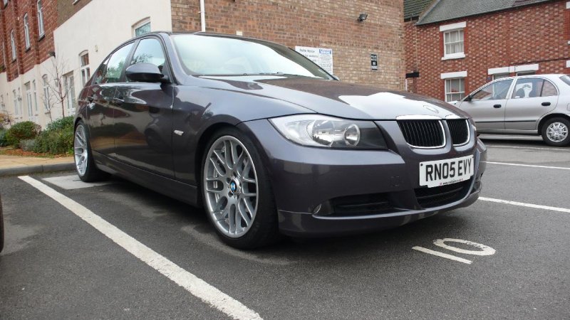

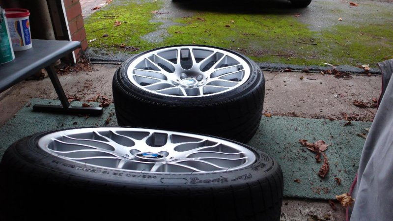

If you buy an E90 3 series, CSL wheels will no fit with standard suspension, the backs are fine (which is odd, considering their width) but the fronts catch on the spring seats so you NEED coilovers (or 20m spacers)
The fronts are wound all the way UP! the rears need setting up properly, one side is about a 1cm higher than the other as it was 11pm and setting heights was getting boring. The back will come down a tiny bit too.
I'm happy, no rubbing, no chafing, no catching at all, amazing.

26th Nov 08 at 13:44   View User's Profile U2U Member Reply With Quote
Fronts need a slight spacer IMO, but looks amazing

26th Nov 08 at 13:50   View Garage View User's Profile U2U Member Reply With Quote
They do, about 10mm or so. I'm a little concerned by the fact that there's less than 5mm between the tyre and the strut

blimey, that looks really good, a bit of spacing on the fronts and it'll be perfect!
