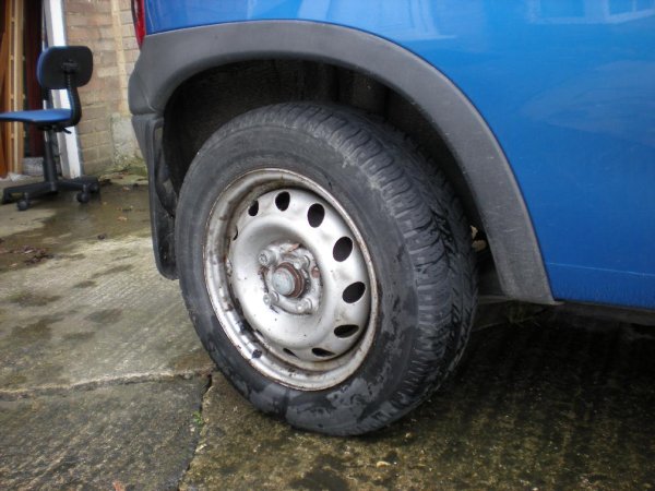

In this one? http://img7.imageshack.us/img7/4137/dscn0289dp8.jpg I'll try and get some better pics soon, but at the moment it means lying down in snow and I don't fancy that much
Just rang the scrappy I've been to before and they have one, want £40 for it
Will try and get my dad to drive me there tomorrow If it hasn't snowed again
Any ideas how much a ball joint will set me back if they have one?

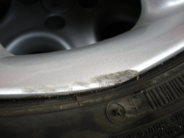

I think he meant the front ball joint, and I think he might be right taking a closer look at the pics, I'm not entirely sure that the front wheel is sitting right. Looks a bit funny to me. That did hit the kerb as well but fortunately not that hard, don't think there's any more than a tiny scratch on it.

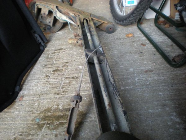

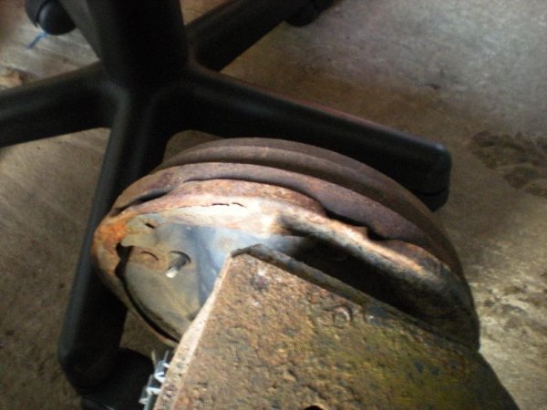

Picked up the new axle
Looks like it has an ARB fitted or something.
Not as heavy as I thought it'd be either Gonna ask them to swap the drums over, though, because these ones are a bit battered. Will get a bearing from the motor factors tomorrow though.

Just happy I've finally got the new axle, with a bonus ARB

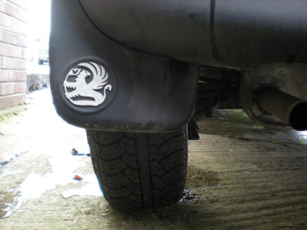

Got some more pics just now
Who needs lowered suspension?

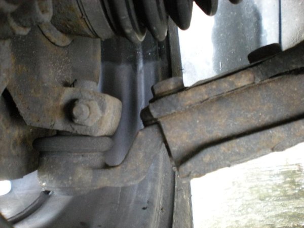

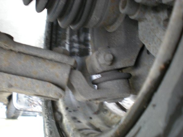

Better pics to compare the front ball joints:
Passenger side
Driver's side

VegasPhil
Registered: 16th Jan 05
8th Feb 09 at 15:14   View Garage View User's Profile U2U Member Reply With Quote
Ball joints look ok to me
I've NEVER seen a beam go like that
