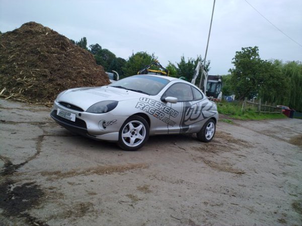

25th Aug 10 at 23:04   View User's Profile U2U Member Reply With Quote
looks so so much better closer to the ground
excelent health and safety ste and orient stylee to

Fleet picca the other day
Today's job
What? I had an axle stand under there on the front cross member. safe as fuck
