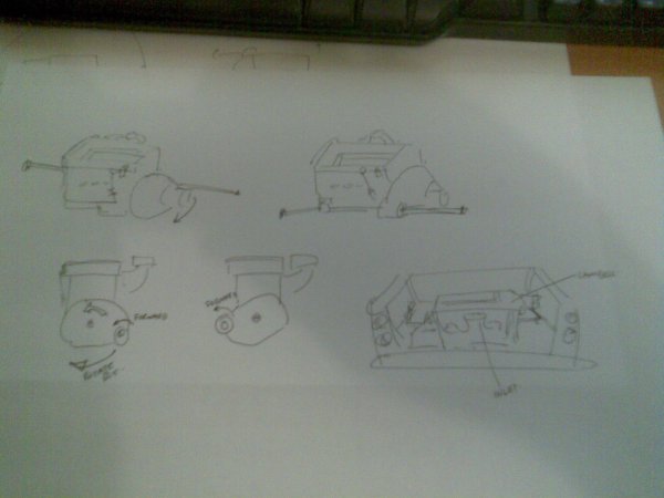

I made some drawings myself
You need the box on the left as you look at the rear of the car, which either means you run it completely standard and have the engine ahead of the shafts, or you rotate the box so the engine is behind them.

1st Feb 12 at 03:50   View Garage View User's Profile U2U Member Reply With Quote
1st Feb 12 at 03:53   View Garage View User's Profile U2U Member Reply With Quote
Labels on the car pic are inlet on the engine and cam belt on the right side.
Box is on the left, shafts ahead of the engine.
Exhaust manifold needs to clear the shafts, shouldn't be too hard because you can bring it out straight at the head by chopping the flange off and lengthening the pipes. Might run worse but its a solution of sorts.

Great diagram... Exactly the conclusion I've came to in my head..
Wouldn't imaging flipping the box to be a huge deal?
this really is an excelent idea Ian, thanks

Any reason it would run worse? Or do you mean because of gearbox rotated
1st Feb 12 at 03:57   View Garage View User's Profile U2U Member Reply With Quote
No the exhaust length, the joins are designed to avoid too much back pressure between each chamber. I was meaning power curve of the engine.
Box rotated shouldn't really cause any problems to it running if its secured strongly enough. Oil supply is the only real concern, not sure where that would leave the filler or whether everything would be lubricated properly.
Does give you some major fabrication to do though, you would probably lose all the mount points, front one will have a shaft in the way, gearbox mount won't be there and the rear mount won't have much to bolt to.
Starter motor will be to cock. Linkage will now be underneath. Probably some more things, good luck
