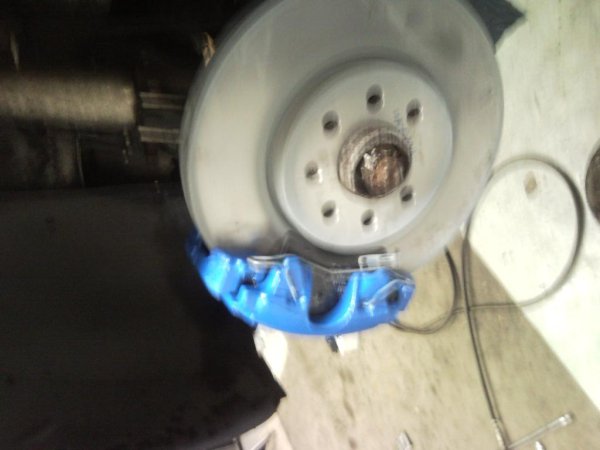

fiat coupe are wrong offset on studs
you need spoigot rings, or you get brake judder.
meriva are already correct size stud, dont need spoigots, and use the standard retaining screw
they are 8mm smaller than the correct discs for them, but the pads dont over hang at all, then just go right to the very edge!
and there cheaper to buy than 288's and the dont have to be redrilled, or the 4 stud 288's are expensive
