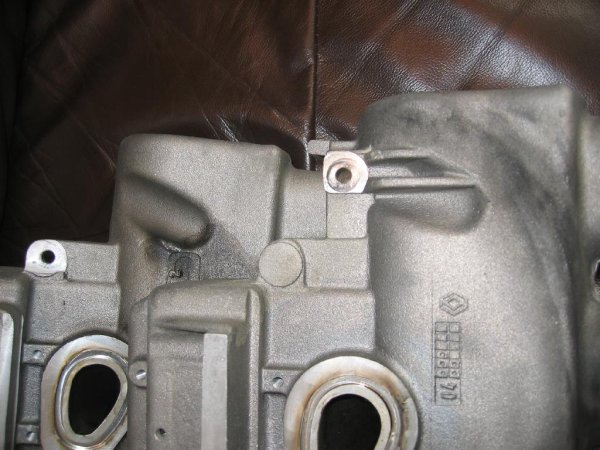

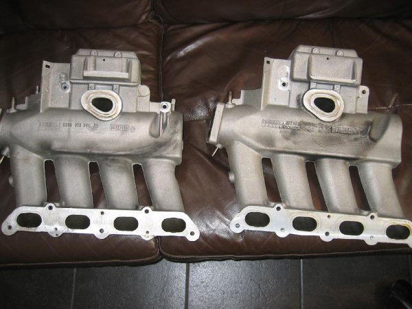

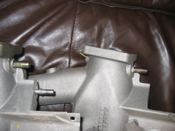

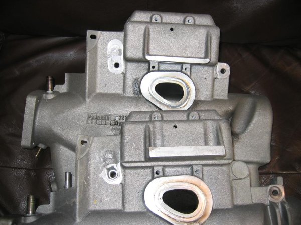

John, No they don't, well i supose they can do, they would need to swap the cam cover tho, and then when they do that they will need to swap the head as the cam cover actually has the cam journals build into it, so its matched to the head or the cams will more than likely lock.
here are some pics of the differences with the 172 and 182.
from the outset the look very similar, even can be confused for the same
however:
172 and 182 have different bolt hole points as above
182 has another take off on it as above
and there is a different casting on the 182 as seen above, this means it physically wont fit onto a 172.
Sorry to put this into your thread paul, but it seems its got some poor information on it, i wouldn't expect willay to know this as he has probably never seen a 172 and 182 inlet off a car.

The fact is lower manifold will fit either a 172 or a 182 (182 and 172 cups have RS stamped ones, with a bit larger tracts), but the upper manifold is different, the canister line goes into the head in the 172 and for the 182 it goes into the upper manifold. It is the upper plelum that is different not the lower inlet. I played dumb just to see what you would tell me.

Picture of the lower inlet
The above picture is the above plelum

fad, i can do you a matched inlet, but the gain is also from reworking the plenum not jus tthe lower section.
on a clio the inlet is commonly refered to the lower and upper section.
also RS inlets are fitted to some ph1 cars, most 172 cups and most 182's but not all
