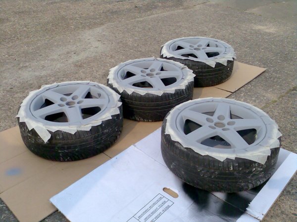

thats silicone mate cunt 2 get rid off panel wipe degreaser best bet and dont spray in a place where aerosols etc have been sprayed in last few days still be in the air silicone is a bastard for sprayers i shud kno i work in a bodyshop lol
im guessing it could be from my tyre shine, i sprayed it with de greaser though
Just give it a good wipe down with come white spirit then allow it to dry before you prime/paint it. They how I've cleaned all mine and its be fine

Its all in the prep mobby, also, is that the first time you've tried spraying anything?

yes, minus wiper arms. i cant prep for shit, all the sand paper and touching it goes straight through me, i shivered all the way through sanding

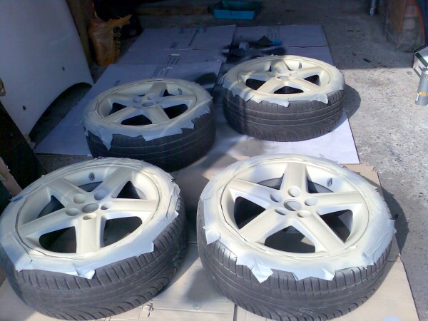

tbh it dosnt look that bad when you look at it, the flash made it look worse, will get anouther pic tomorrow

well condsidering youve got over spray, underspray, havent done the edge of the spokes and havent dont the back of the wheel.
I would personally say that isnt a great job

wheres all this degreaser and flash come from???? key it down, cellouse (cant spell) thinners, prime and spray...its allways trail and error though mate...you get reactions and stuff...PREP makes the whole spray job though! well done for trying but dont loose hope on them now!...get back to it!
Adam-D
Registered: 11th May 02
17th Oct 08 at 09:03   View User's Profile U2U Member Reply With Quote
my wheels took a couple of weeks to do properly
i had to sand, fill and then fill with dolphin glaze cos of pin holes, and paint and sand loads.
richc
Registered: 24th Mar 07
Location: Ilkeston
17th Oct 08 at 09:12   View User's Profile U2U Member Reply With Quote
Clean to fook (pressure wash) then sand...then clean (solvent degreaser)....sand, clean, sand and keep going untill you get what you want.
The mist it on. Very very light, and keep going to create the layers, not just go it in one thick hit.
Hold it probably 200mm above the wheel and presser the button on the can, and gently move across. Let go of he botton, then doit again and moe back across, and keep doing it untill you get a thin layer. let it dry. Then do it again and it might take 6 layers.
Then a couple of layers of laqur doing the same thing.
