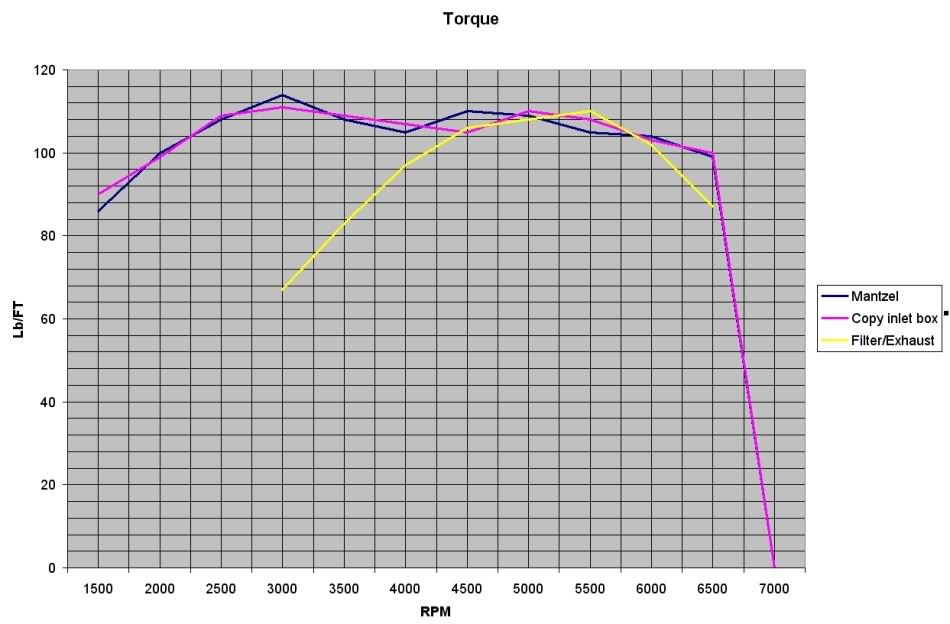

Torque comparison.
Yellow line is standard inlet, look at how much gain the inlet box gives in the lower rev range.

Originally posted by Vaux Lad
Whilst on the topic
I converted a few RR graphs(when i was bored at work ) into excel format(using some printouts off here, and some of my own)
So its easier to compare them.
And as you can see, the mantzel, and copy inlet are VERY similar it terms of peak power, and over the complete rev range.
It also shows why fitting dbilas tb's with std ecu/rev limit is completely POINTLESS(apart from the noise), they loose power throughout the rev range apart from the final peak.
The light blue line is my own engine now
Mantzel-From Steves graph
Dbilas inlet-From the graph Dave posted
Dbilas tb's-Warren G's graph
Std(exhaust/filter)-My engine last year
Going by peak figures, the TB'd engine is quicker, but it wont actually be, on the road
[Edited on 29-03-2008 by Vaux Lad]

Paul_J
Registered: 6th Jun 02
29th Mar 08 at 23:23   View User's Profile U2U Member Reply With Quote
Something not right there...
If your 'standard inlet' is the same car in both...
at 4000 rpm...
The standard inlet makes 96 lb ft of torque and 90 bhp @ 4000 rpm(according to your graphs).
and mantzel 106 lb ft and only 84 bhp. @ 4000 rpm. (according to your graphs)
This is fucked up...
standard inlet 96 * 4000 / 5252 = 73 bhp - NOT 90 bhp like your graph says
manztel 106 * 4000 / 5252 = 82 bhp
manztel is fairly spot on according to your graph, but your graph showing power on standard inlet is completely wrong.
Let's look at 4750 rpm - According to your graphs
Standard inlet makes 105 ish bhp and 107 lb ft of torque. @ 4750 (according to your graphs)
Manztel inlet makes 95 ish bhp and 110 lb ft of torque @ 4750 (according to your graphs).
Lets do the sums again
standard inlet - 107 * 4750 / 5252 = 96 bhp -NOT 105 bhp like your graph says
manztel - 110 * 4750 / 5252 = 100 bhp
You've seriously cocked up plotting the standard figures on your BHP graph mate or torque graph... one is completely wrong.
This blue line compared to the yellow line of the other graph is completely wrong!!!
According to the yellow line (torque) on the other graph, that blue line should be well under the manztel figures throughout most of the rev range.
[Edited on 29-03-2008 by Paul_J]

Vaux Lad, who's standard inlet graph did you use? It just looks wrong. Here's mine....

Cheers for pointing that out Paul, aye i copied the figures into the wrong column on the speadsheet
Will sort in when i get a min.
