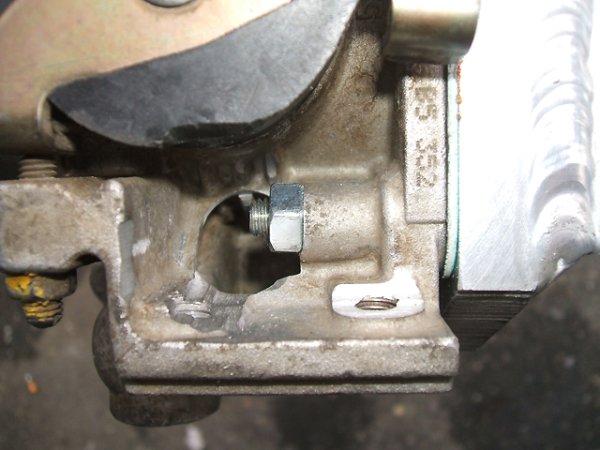

Here it is
Going to fit it on Friday afternoon

Bit confused now....looks like i dont need to drill the throttle body?

27th Jul 07 at 15:34   View User's Profile U2U Member Reply With Quote
After playing about with it...
you need to drill out the 4 mounting holes to a 7mm hole.
Then you need to modify the shape of the throttle body to allow you to fit a nut on the bottom stud. Lot of sanding with air tools lol

i didnt do the modifying of the tb and i cant get that nut on now??
its been sealed aswell so dont think i will be able to take it off to do it??
