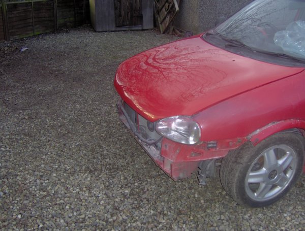

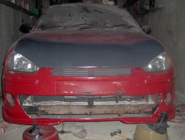

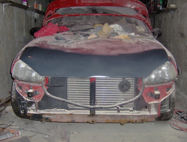

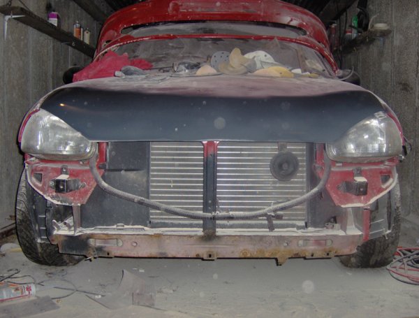

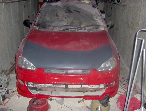

Hello all again, right...its all repaired again....finally got it in primer again....got a few pics here of the first coat of spot primer(just to see if there was any imperfections etc)
And here it is with a bumper on..bumper is been held up by 2 buckets so not perfect lol(ignore the chopped up bumper aswell.....work in progress for a different project lol)
So yeah....going to my mates booth 2moro 2 be properly primed and painted.
Should look shit hot.
Pics to follow 2moro

opinions?
6th Jan 07 at 23:21   View User's Profile U2U Member Reply With Quote
i would be more worried at how rusty the lower panel is personally

hahaha lol yeah...car is just a shell tho.....its fucked....so i use it to do my bonnets and boots on etc. But yeah if i come to sort it out and fix it....i shall be sorting that crap out lol. Cheers

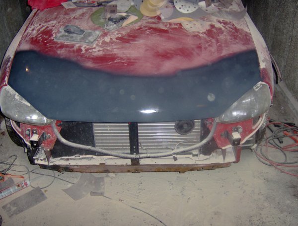

Hello all....here are the pics of it finished....bonnet isnt closed and camera isnt of best quality but you can basically get the jist.....all done now.....been sent AGAIN lol....N e way here ya go:

Well wot we did becuase the car its going on has a irmy grill was got the draw a straight line about a cm away from the edge of the steel...then we folded it over flush to the back for strength...welded it, flared it abit so it would fit over his grill...then we dollied it until the metal was spot on (no highs, or lows) then sealed the underneath where the 2 metals joined, and painted it. Looks mint i personally think...had to do a repair to abit of rust but acid8 the lot and then selaed that 2.
