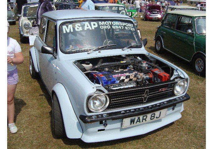

guy up the road is doing the v-tec mini at the moment, waiting for the new frame, got all the engine wiring and most other parts ready for it

XE'd Mini
Kits are avalible to do it as well
