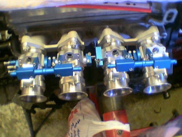

you could buy a throttle body kit, omex management and custom loom and all fully fitted from me for £2300 and get 160 bhp.

these:
you can buy them from novatech, they are £1600 plus vat. for £2300 i will supply, fit them, new pipercross filters, custom made loom, omex 600 series ecu, supply you with a base map, drive in drive out.
[Edited on 23-09-2005 by corsa808]
23rd Sep 05 at 22:59   View Garage View User's Profile U2U Member Reply With Quote
is the loom supplied from novatech?
or do you make that?
Dave A
Registered: 10th Dec 03
23rd Sep 05 at 23:01   View User's Profile U2U Member Reply With Quote
i make the loom. all loom parts are supplied by omex so its propper stuff.
