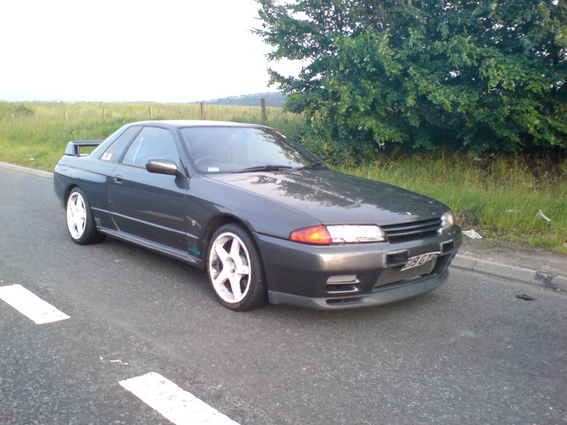

Lowered the front suspension about 15mm (will raise the rear a touch tomorrow).
see height difference here
http://www.trackscotland.co.uk/images/track/dreadnaught/dreadnaught29.JPG

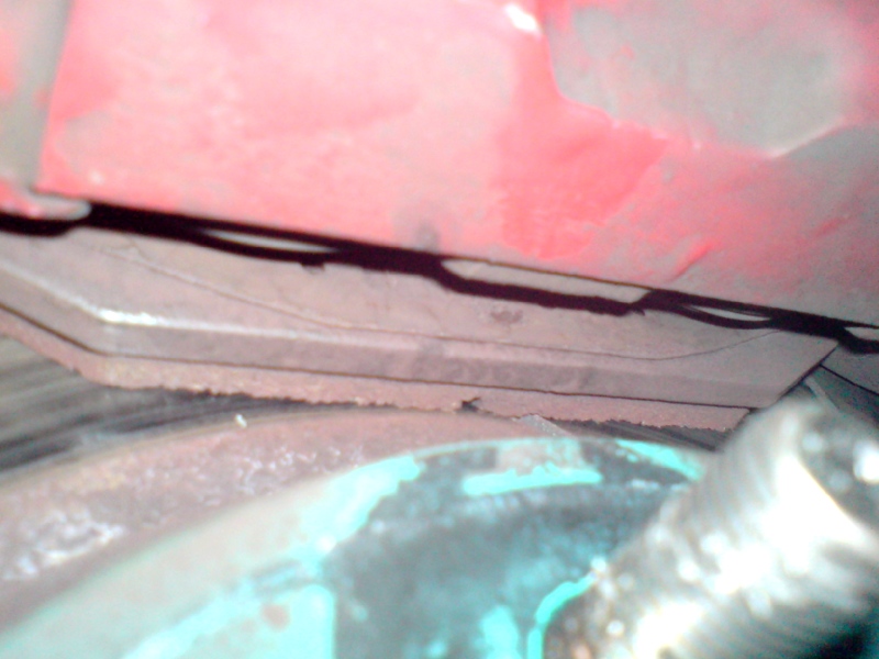

Checked out the front brakes... the discs dont look to have deposits of pads from hot stops. The dont appear to have even wear from the pad though. The discs appreared to become warped halfway through the dreadnaught night, getting worse as time went by. Causes? I dont think i've run them too hot?! I try not to keep my foot on the brakes when hot etc. They were bedded in.
I have new DBA4000's on the way, but i'll remove the MU's and get them skimmed as a spare set.

New DBA 4000 slotted discs arrived today. Good service from RB Motorsport, next dat delivery. They look less gay than the mangled MU's, and have funky temp indicators on them. 3 different strips that changed colour at certain temps.
trying to work out what happened to the old ones as they are showing very little wear, and lasted about 4 trackdays There is only 1 spot which looks like the result of a hot pad being stuck on. Maybe i just didnt bed them in enough/get them through enough high enough heat cycles.

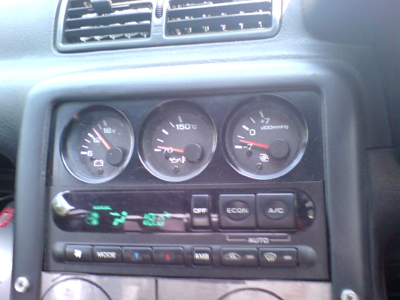

gave the oil cooler a long test today in quite warm weather....
the plate seems to open around 65-70 which is lower than i though it would be (any ideas what is supposed to be set at?)
Overall oil temps whilst driving round town etc (reading diff's off std gauge before and after) are down by about 10deg. From just under 90, to just under 80, maybe more liek just over 70.
Out on the road with some spirited driving - from around 100-110 down to about 88-90.
Seems to be working well then. Will test it on track tomorrow night. Could only get about 4-5 laps in before the gauges was starting to go north of 110 on Monday eve

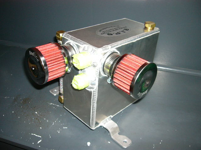

new catch tank from RIPS NZ
http://www.ripsltd.com
