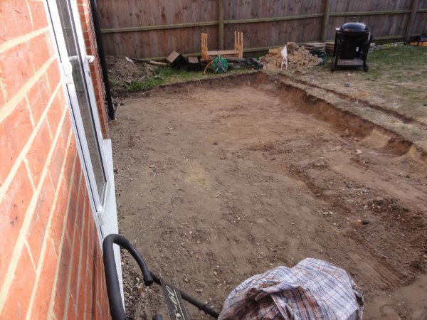

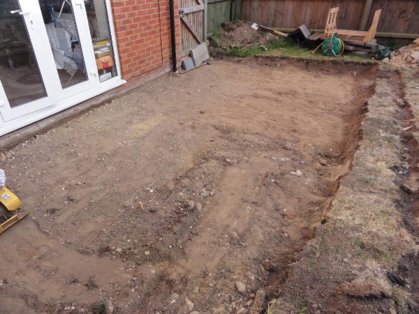

2nd Jun 11 at 18:06   View Garage View User's Profile U2U Member Reply With Quote
All dug out, leveled roughly and compacted down as had to dig some big lumps of concrete out (Fucking builders)
Getting there now

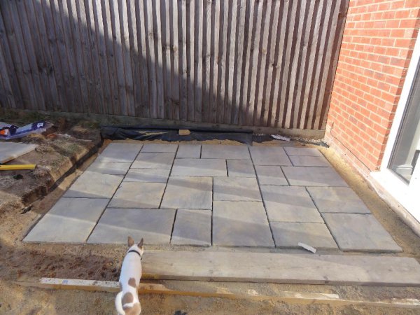

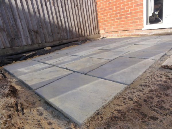

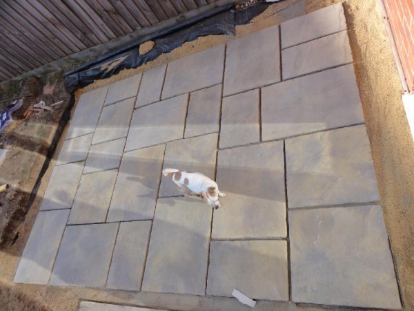

Spent a good day out there today from about 11am till 4pm. Managed to use up all the tonne bag of sharp sand i had, thought that would have done half of it, instead it just did one of the three patio kit packs.
I can honestly say its the hardest diy job i have ever done. I think i bit of more than i could chew for my first patio build. Instead of perfectly square same thickness slabs, i have completely random thickness as well as off square slabs. Its an F-ing nightmare.
Its not quite looking square to the edge where the next pack will go from inside the house, but its exactly 200mm from the wall all the way along, and exactly 14inches from the fence all the way down the side.
Anyway heres some pics.
Came complete with a guard dog
Daniel_Corsa
Registered: 21st Apr 04
Location: Wigton, Cumbria
4th Jun 11 at 18:29   View Garage View User's Profile U2U Member Reply With Quote
Looks good, could you not have mixed it up slightly so don't have solid lines running through it all? Are you laying three identical patterns or going to mix and match?
Dan
Registered: 22nd Apr 02
4th Jun 11 at 18:45   View Garage View User's Profile U2U Member Reply With Quote
That would have been nice to do it mixxed up as to loose the lines, but thats how the kit comes, and no matter how hard i tried or looked around i couldnt get it to work any other way.
Tbh, you dont even notice the lines when you look as it.
I think when i lay the next one i will rotate it 180 degees or something so that its not the same
Daniel_Corsa
5th Jun 11 at 10:03   View Garage View User's Profile U2U Member Reply With Quote
Still looks great Dan. Was just first photo with dog on made that full join stand out and likewise at top.
I'd 100% rotate 180degrees just to mix the pattern slightly.

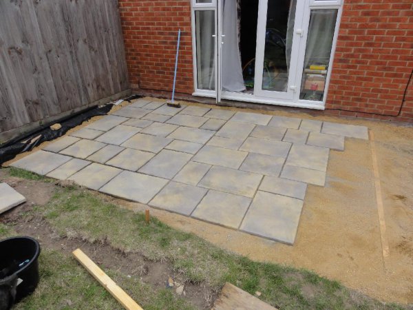

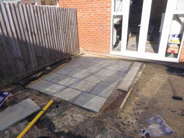

Well after a bit of a break, ive had a little bit of a crack at it yesterday and today before work, only had a few hours a day so cant do to much.
If the weather holds out (which i highly doubt) ill be able to finish the laying by friday. But i highly doubt i will.
Anyway, laid the second bed of sand, compacted and screeded off. Started laying the second pack, but due to screed rails not being quite wide enough, i cant lay the edge piece until i do the next bed of sand.
Daveb, there seems to be mixed reviews on the resin im using. Alot of people are saying its rubbish, others are saying its amazing stuff. I was very impressed with the sample i saw in the builder yard. Will see how it goes.
