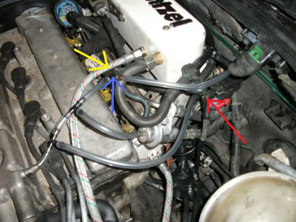

19th Feb 10 at 14:31   View Garage View User's Profile U2U Member Reply With Quote
it was bolted like dean said and also did anyone else have a pipe heading downwards?
looks like it was blowing air onto the cat?
19th Feb 10 at 14:34   View Garage View User's Profile U2U Member Reply With Quote
yellow - where does this go? whats it for?
blue - where does it start? ive got no connection near the servo?
red - where does it go?
the small coolant hose, do you connect that to the other hose further behind the engine?

19th Feb 10 at 17:07   View User's Profile U2U Member Reply With Quote
Not sure on the yellow, looks like its going down towards where the throttle body used to be.
Blue is a vacuum pipe, looks like he has used a T-Piece and thats what the blue arrow is poiting at
Red looks like its coming off the fuel tank vent switch. ( I think thats what it is). On the standard manifold its clipped on the battery side. This pipe goes behind the bulk head and kind of follows the same course as the fuel lines.

19th Feb 10 at 17:10   View Garage View User's Profile U2U Member Reply With Quote
sorted the red
the yellow on mine is blanked
and the blue i have no where to fit it to the mantzel! only has fitment for the servo

19th Feb 10 at 17:12   View User's Profile U2U Member Reply With Quote
Do you have any items that need a vacuum and no place for them to get it off?
19th Feb 10 at 17:15   View Garage View User's Profile U2U Member Reply With Quote
yeah
fpr
afm
ftvv
rocker cover
also there is a pipe coming from one of the inlet/outlets on the right hand side of the rocker
guessing thats not needed?
dean101287
Registered: 22nd Jul 07
Location: Cardiff
19th Feb 10 at 17:21   View User's Profile U2U Member Reply With Quote
Strange how there is no vacuum take off on the mantzel. My dbilas had too many and I had to blank one off. Can you take the blank off the one thats labled yellow up there ^?
Also the picture above, he seems to have taken a vacuum off the brack servo pipe and then T-pieced it to where he needs.
19th Feb 10 at 17:26   View Garage View User's Profile U2U Member Reply With Quote
Originally posted by jamesy1990
just finished mine mate wasnt hard , just remember to buff 5-10mm off the bolt on the altanator bracket!!!
you can see there its not t pieced
i did look at using the one that was blacked off but didnt know if it would work

19th Feb 10 at 17:31   View User's Profile U2U Member Reply With Quote
Yes you could use the one thats blanked off.
Whats not T-Pieced? The vacuum pipe looks like it coming off the union thats on the brake servo, then it has 3 T-pieces going off it.
19th Feb 10 at 17:32   View Garage View User's Profile U2U Member Reply With Quote
yeah
i thought you meant he had put a t piece in the brake servo

19th Feb 10 at 17:35   View User's Profile U2U Member Reply With Quote
the bit of braided hose from the mantzel goes onto your egr valve , i blanked mine off but it still has a fitting attached for a vacume , the red is a vacume from the vual tank vent valve , it shouldnt be disconected at the other side as u shouldnt be anywhere near it , the blue is my vacume network , i have a little nipple that comes off the brake servo vacume on the mantzel , you run a racume from the mantzel to the rockercover nipple , then u cut it in the places and insert 3 t peices first one goes to map sensor on bulk head next to coolant bottle . second vacume goes to the fuel presure regulator and the third and final vacume goes to the fuel tank vent valve (little black box with blue and red plug )
