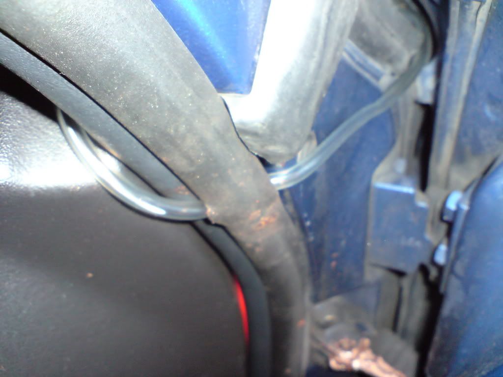

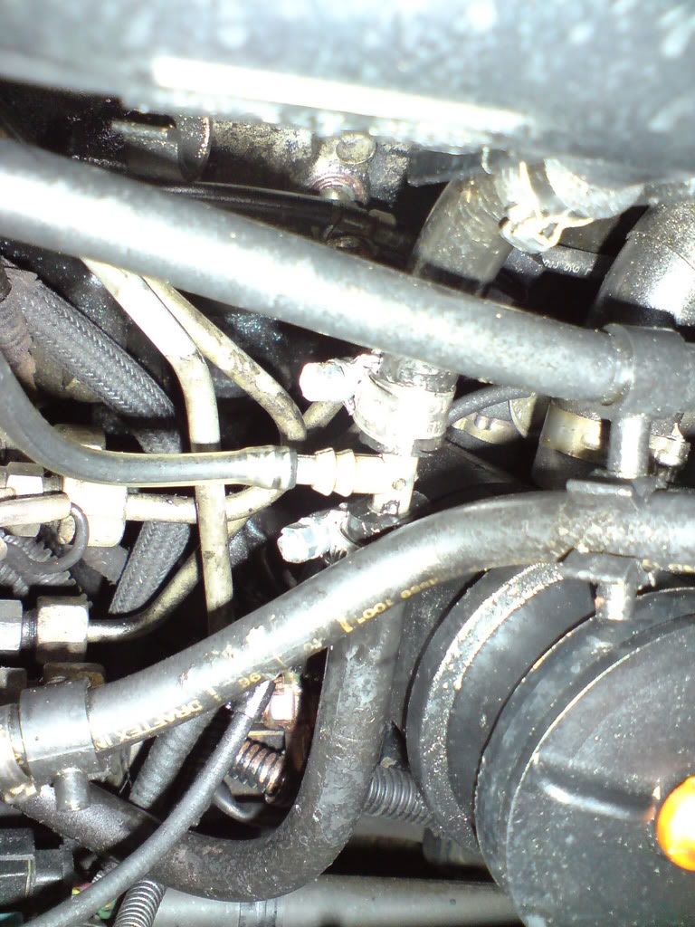

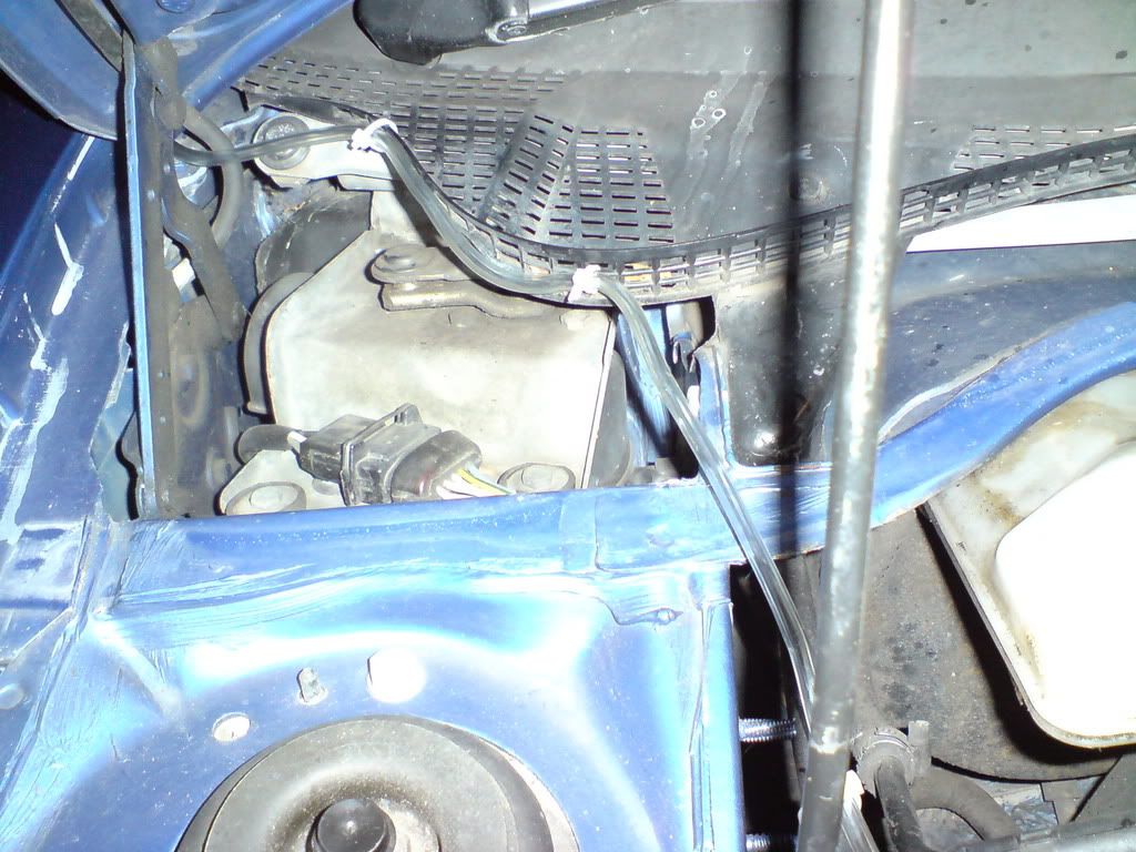

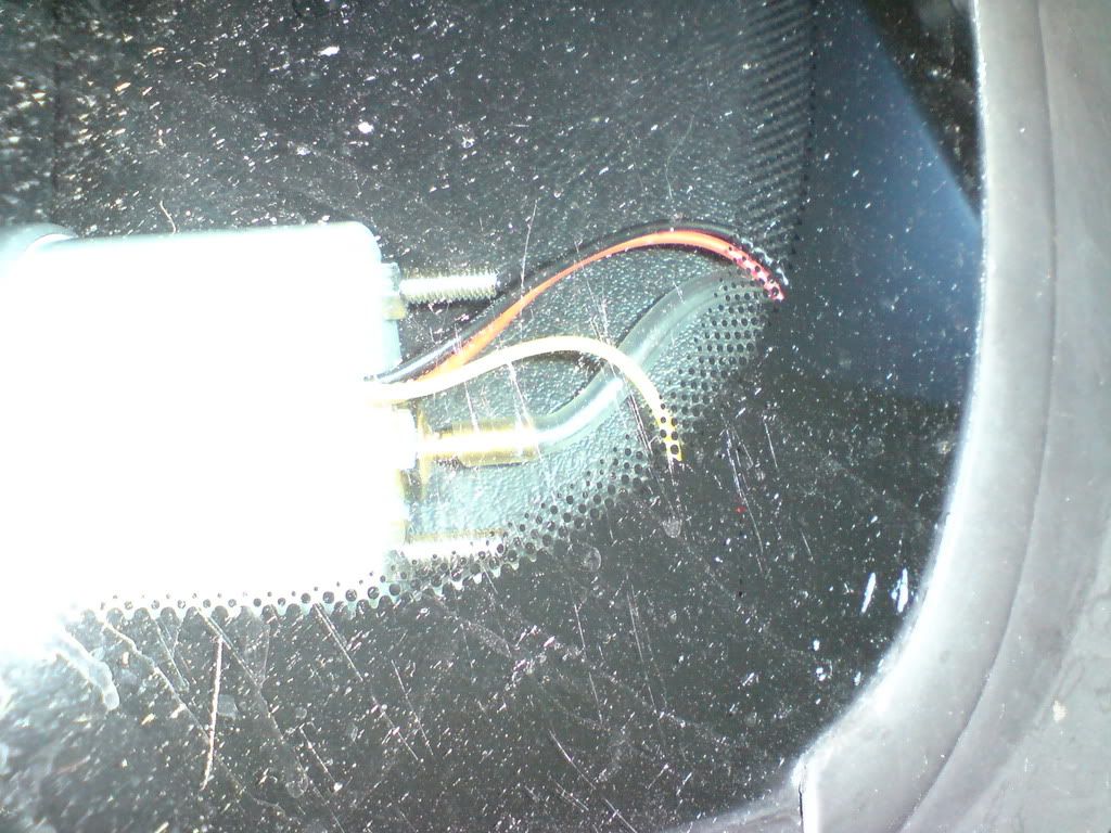

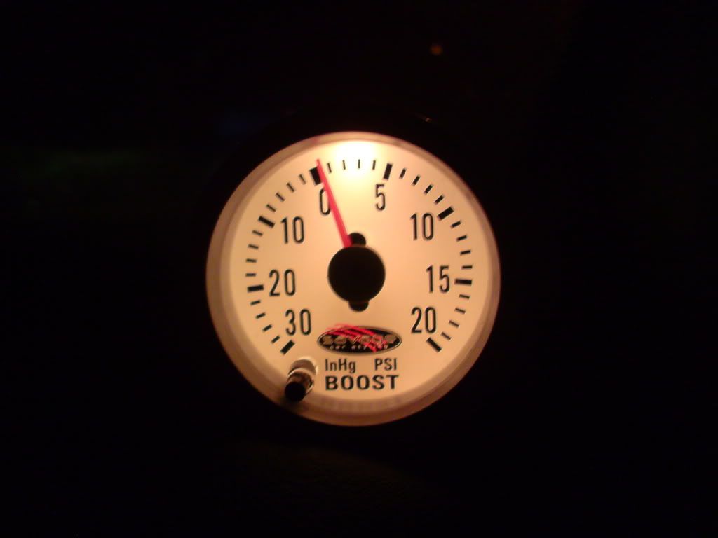

This is a guide for fitting a boost gauge. The pictures were taken tonight when i was messing with the car, hence why there's not many of them. Feel free to comment..
1. Find the hose that goes to the front of the intercooler in between the fuel pump and fuel filter housing.
2. Cut this hose anywhere you like, and insert the T-Piece, it may be a good idea to use jubilee clips to make sure you get a nice tight fit to avoid leaks. Then attach the transparent tube to the third part of the T-Piece (you can see what I’m talking about in the picture below).
3. Find a suitable way to run the pipe towards the cabin. I decided to run the pipe along the accelerator cable towards the wiper motor. Cable tie the pipe securely and make sure it doesn’t get snagged on anything. I chose to run the pipe down to the door through the wing as shown in the picture below.
4. Using a screwdriver you can poke a hole through the door seal. This will let you run the pipe through the door without worrying about it getting trapped in the door.
5. Decide where to put your boost gauge and then cut off any extra pipe you don’t need. Make sure you don’t cut off to much though!! Push the pipe on the connector on the back of the boost gauge as tightly as it will go.You may want to use a gauge pod, but I have bodged mine in place using bluetac.
6. If your boost gauge has wiring to the lights, then you will need to read the instructions to see how to wire in. I found the best place to wire to was the car stereo wiring as it has a good earth and live cables as well as a light controlled live. I routed my cable by removing the a pillar trim and running the wire down the door seal and underneath the fusebox. From there you can then push the wiring up to the back of the radio.
7. Take your boost gauge for a test drive and make sure everything works as you want it to!

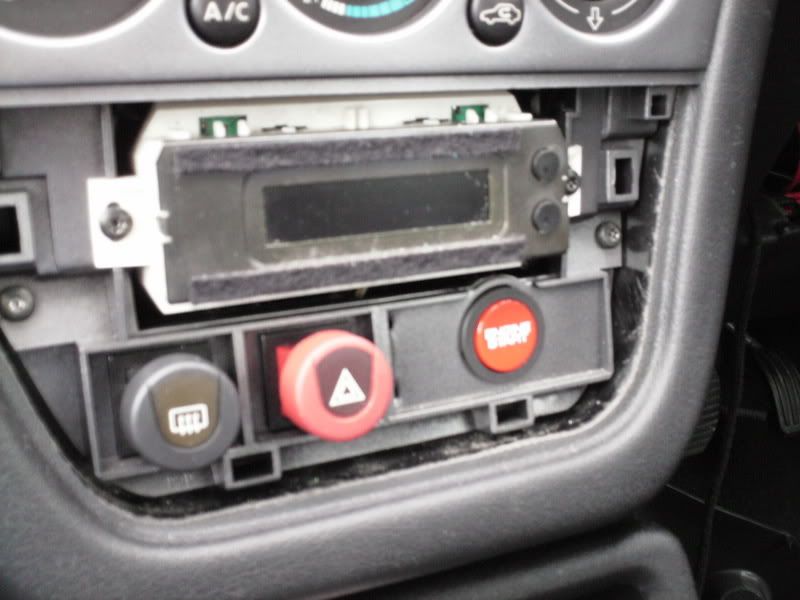

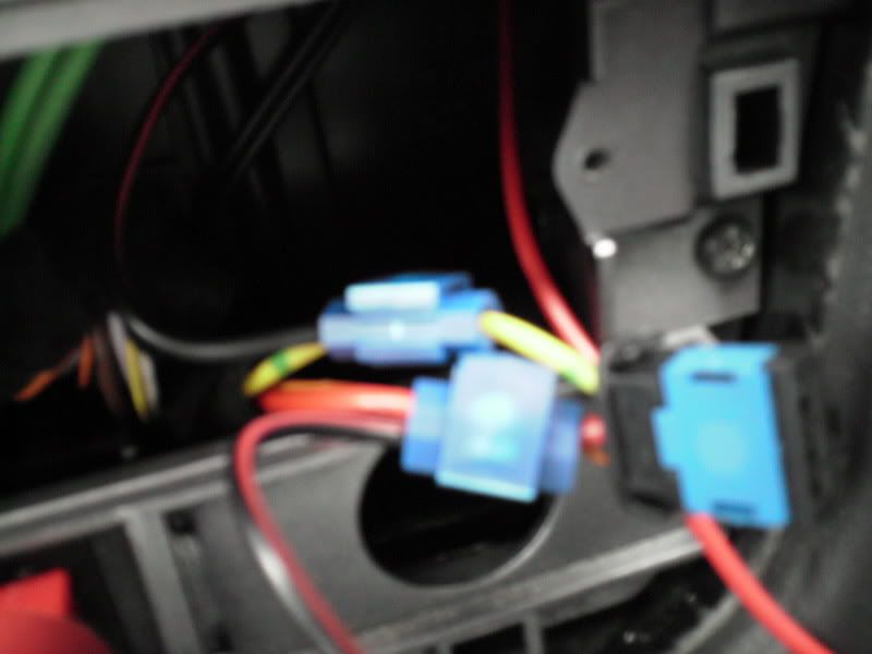

push button start
Firstly, this is what you get in the kit, it cost me about £15 from ebay:
1x Push Button
1x Relay
4x Snap lock connectors
Wires to connect it all

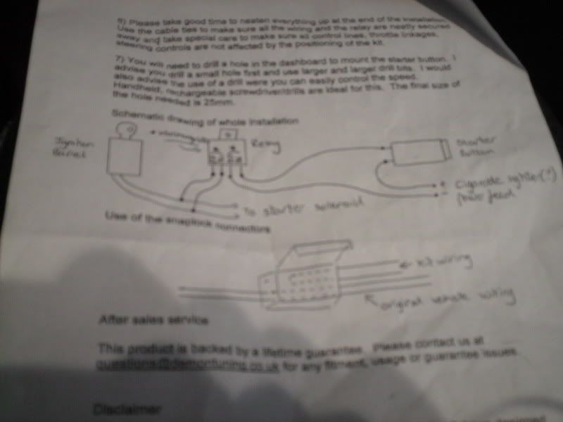

These are the instructions that came with it, blurry though as my camera is poop:
So, installing it all.

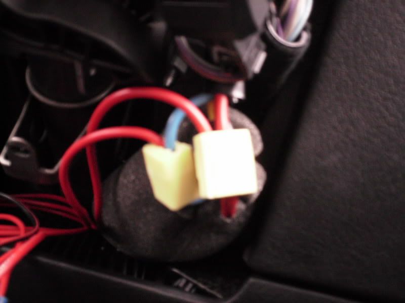

Unscrew your steering column shroud, this is held on with 3 torx screws, 2 of them are right barstewards to get out but persistance is key, once thats off you will want to locate the biggest RED wire and the BLUE wire coming from your ignition, these will be just below where you put your key in
you will want to connect pole 87 and pole 30 of the relay to the RED and BLUE wires using whatever method you like (doesnt matter which way round you do this bit), i used the snap lock connectors because its quick and simple:
Next you will need to take the bottom half of your centre console out (the bit with the cig lighter in), you dont NEED to take the whole centre dash bit out with the stereo, but it will make your life easier
so take the nice fascia off, it just pulls off easily, then you will see 2 torx screws holding your clock in. (assuming you have one) disconnect your clock.
Disconnect your cig lighter, just pull the stupid connector off, mine was very stiff. you will then need to remove the cig lighter, theres a small torx screw right inside it that will help dismantle it, frankly it took me about 10 minutes to slip it out of its plastic housing as its clipped into the dash quite firmly.
You will then see you have a YELLOW and a RED wire going into the connector that was on your cig lighter. You must connect pole 85 of the relay to the YELLOW wire. the RED wire must be connected to either terminal on your push button. Again i used some smaller snap lock connectors as this crappy picture shows:
You then have one remaining pole on your relay, number 86, connect this to the remaining terminal on your starter button and thats all your wiring done!
I simply tucked the relay and all the bulk of the wiring up to the left of the steering wheel, none of its visible once you put everything back together
Now be prepared to spend anything from 20 minutes to 4 hours getting that sodding steering column shroud on and 10 seconds putting your clock back in.
This doesnt drain your battery and requires no soldering or wire cutting, you just need a pair of pliers if your going to use snap lock connectors, which i suggest you do
Next up will be where and how i relocated my cig lighter
Disclaimer: i accept no responsibility if you electricute yourself doing this, you are dealing with live wires if your silly enough not to disconnect your battery

That boost fitting guide, i wouldnt go the way they done, theres a small hole on the pass side just below the glove box feed the pipe through that job done plus looks better than going through the door way ect
thats what i done and the boost guage still managed to sit on the drivers side so i could see everything
you can just make out where mine was, where the cd player goes was able to see it with a clear view ect but was a temp place for it untill i got my cd player fitted

My mate made a custom mount for his boost gauge here:
And everybody on Pug306 wanted to know how to do it lol. It did look smart tbf and it lit up orange at night so blended in perfectly.
