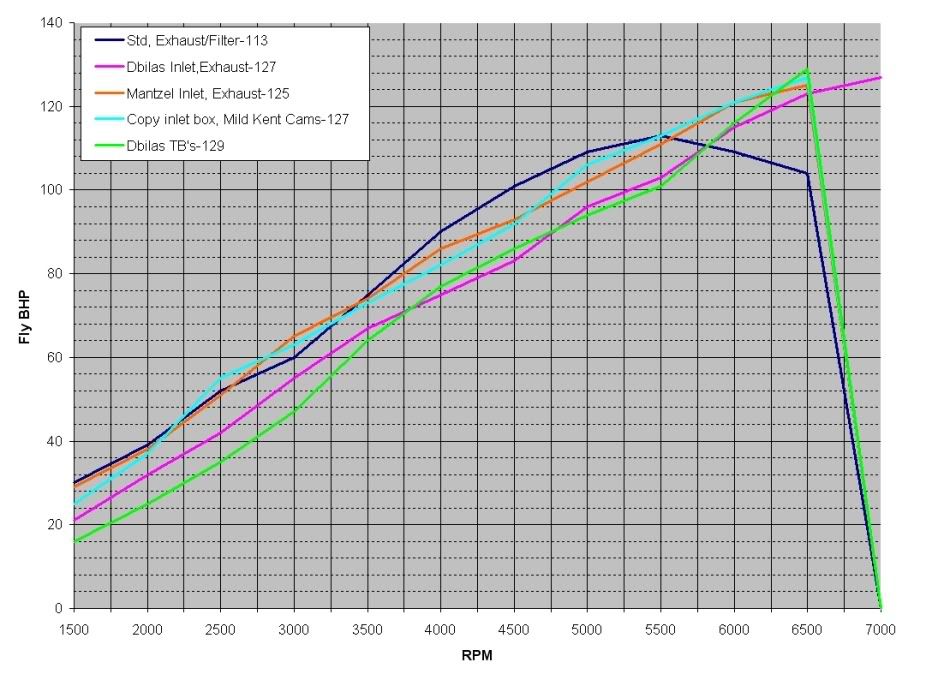

Whilst on the topic
I converted a few RR graphs(when i was bored at work ) into excel format(using some printouts off here, and some of my own)
So its easier to compare them.
And as you can see, the mantzel, and copy inlet are VERY similar it terms of peak power, and over the complete rev range.
It also shows why fitting dbilas tb's with std ecu/rev limit is completely POINTLESS(apart from the noise), they loose power throughout the rev range apart from the final peak.
The light blue line is my own engine now
Mantzel-From Steves graph
Dbilas inlet-From the graph Dave posted
Dbilas tb's-Warren G's graph
Std(exhaust/filter)-My engine last year
Going by peak figures, the TB'd engine is quicker, but it wont actually be, on the road
[Edited on 29-03-2008 by Vaux Lad]
Steve X16XE
Registered: 31st Dec 06
29th Mar 08 at 17:40   View User's Profile U2U Member Reply With Quote
So from 3500 to 5500 the standard inlet produces more power
Vaux Lad
Registered: 15th Dec 04
Location: Stoke-on-Trent
29th Mar 08 at 17:43   View User's Profile U2U Member Reply With Quote
Quite possibly? That was my engine last year, with a full 2" system, and a de-cat. Standard bar that.
Or that may be my dodgy graph reading :lol
But between those sort of revs is where the standard engines power and torque peaks.
But the std engine produces much less torque at low revs
