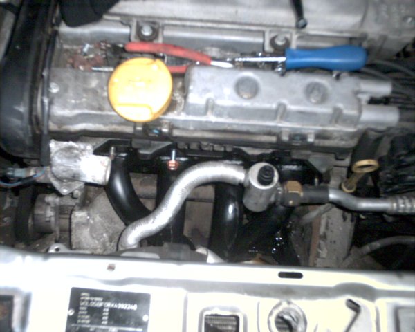

good job i got the manifold and a new cat, the joint flange has litrally turned to dust as i was undo-ing it,
gonna be a bastid to remove the manifold thou, with aircon and power-steering in the way
Adam-D
Registered: 11th May 02
20th Jan 07 at 17:44   View User's Profile U2U Member Reply With Quote
right so far
removed old manifold, fitted new manifold and fitted new timing belt and running gear
new belt on
old manifold
one of the reasons the manifold was junked
to get new manifold in i had to remove oil filter and front engine to box bolt
and new manifold on

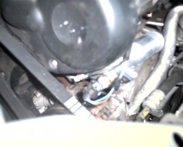

new thermostat, turns out mine has a expensive one and its all one pice woooo
exhaust fitted
subtle as you like fitment on the tailpipe
lambda fitted
new sensors and thermostat "which ended up goin back cos it was the wrong one" so went back and had to get the £30 odd one cos its all built in
and them fitted

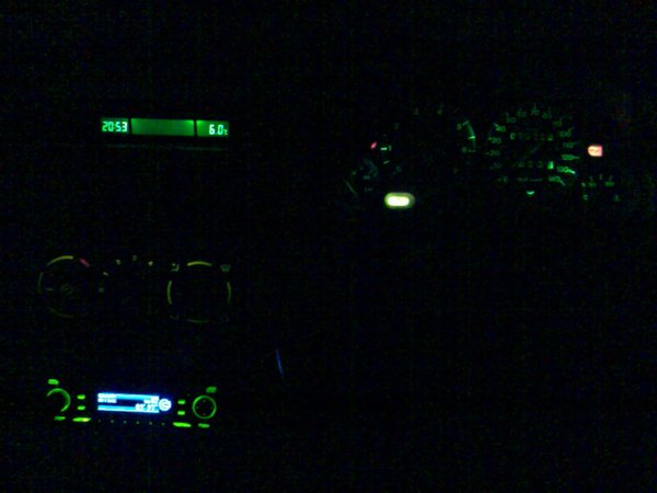

small miracle has happened,
3 aircon centre console later, 2 sets of bulbs, 2 sets of led's and strip and restrip of the dash about 6 to 8 times, i hae finally got all the dash lights on and working
1st console the aircon knob was glued so when i undid it it snapped,
bunch of £ later i had another console, from a guy off here "1.5td" stripped it took the bulbs out fitted green ones, putting aircom knob back in,,,, snapped it BOLLOKS,
3rd console from mylo stripped it, fitted bulbs, put all back together, right hand bulb failed, strip it again, re-fit all working, then left hand bulb fails, then upon removal it explodes bugger.
so using a spare swich from one of the other consoles and a bit of gentle purswaysion i got it all on and back together, and then got the mfd lit up properly aswell
wooooo
essay i know and not major mod but its taken me ages cos of the air con etc
best pic i can get im afraid but im sure you can figure it all out

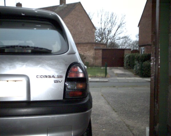

fitted rear suspension, fitted headlights, waxoiled rear arch`s,
some pics,,
before lowering the rear, "the front has alredy been done"
old suspension off
comparing the vaux top mount to aftermarket top mount, i decided the same as last time i did my suspension to use the vaux top mount as its fatter and more substansial, ive heard aftermarket topmount knock occasionly, so to prevent this i used the vaux top mount
i wire brushed the inner arch and like the front got half a lawns worth of soil out
all wire brushed down
new suspension in, and waxoiled
and how it sits now
and my new headlight arrived so i fitted them up aswell
