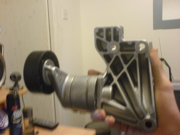

If your going to take off the gsi pump you need a, lower alternator bracket, belt and tensioner off a 1.4 16v 1995 model non pas or aircon

thought i might have to mess with the belts etc

just need a pic or part numbers for a non pas, non aircon belt conversion
anyone got a pic of belt setup on a x14xe non pas and air?

i hear i need one of these
Rileysport
Registered: 18th Jun 04
13th Jan 06 at 08:39   View User's Profile U2U Member Reply With Quote
yes... yes you do
Siberia
Registered: 9th Oct 03
13th Jan 06 at 10:37   View User's Profile U2U Member Reply With Quote
or bodge your own...
