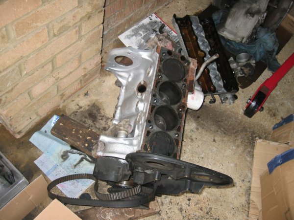

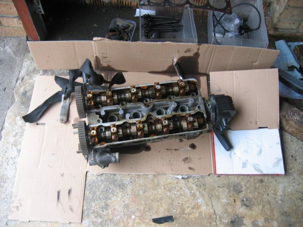

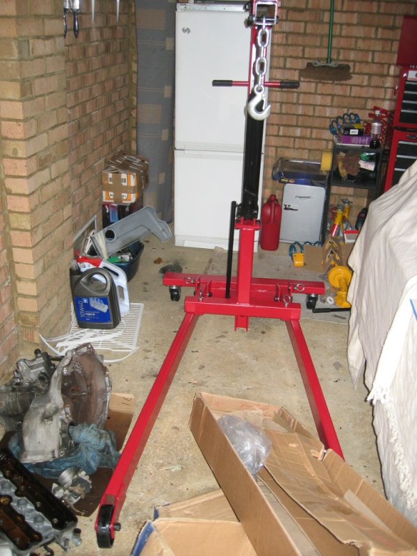

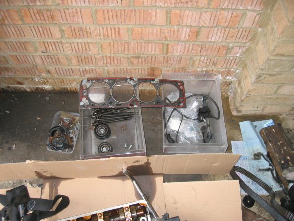

piccies.....
bottom end
old head bolts and stuff

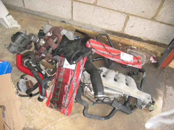

new gaskets, inlet loom etc

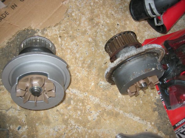

old water pump, new water pump
head
the engine removal tool....
[Edited on 14-10-2005 by broster]

that waterpump a standard item ????
broster
Registered: 6th Dec 02
Location: Drives: E39
14th Oct 05 at 14:09   View Garage View User's Profile U2U Member Reply With Quote
yeah....
Rileysport
Registered: 18th Jun 04
14th Oct 05 at 14:11   View User's Profile U2U Member Reply With Quote
looks a bit funky thats all

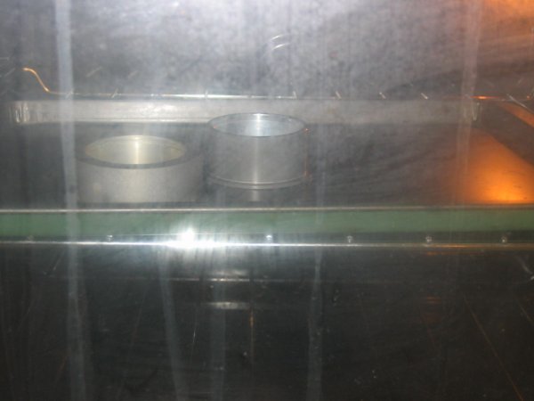

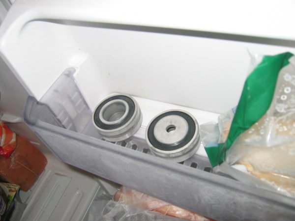

14th Oct 05 at 14:20   View Garage View User's Profile U2U Member Reply With Quote
new sbd bearings....
inner in freezer
outer in oven

WTF

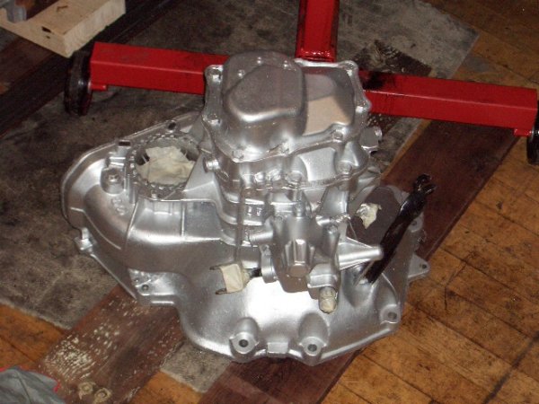

get that gearbox cleaned up as well, should look like this:

14th Oct 05 at 21:10   View User's Profile U2U Member Reply With Quote
Originally posted by Ojc
WTF
Simple physics. Inners contract due to cold, outers expand due to heat, then take em out, slip the inner into the outer and leave them to reach room temp. When that's done, they'll be firmly sealed together.
