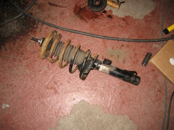

Good progress. Did you fit the other brake line I made before I left?
That 11mm, can we swap it for a 10mm? It might get used then
21st Aug 09 at 20:42   View Garage View User's Profile U2U Member Reply With Quote
No the other brake line isn't done. I would like to get them held properly and make sure the lengths are correct, fit and bend as its routed. Otherwise there will either be loads of slack or it'll be in the way of stuff. There's not loads of room behind the dampers. Wouldn't mind reviewing where the rear goes through the bulkhead as well.
[Edited on 21-08-2009 by Ian]
Ste
Registered: 5th Mar 03
Location: Taif, Saudi Arabia
21st Aug 09 at 20:45   View Garage View User's Profile U2U Member Reply With Quote
They can be shortened easy enough, so get them routed and leave any slack and i'll make a new end tomorrow. I'll get some p clips in a bit while i think on.
21st Aug 09 at 20:47   View Garage View User's Profile U2U Member Reply With Quote
Can't really route without the clips. Still got the other damper to do and the exhaust so I'm not short of work.

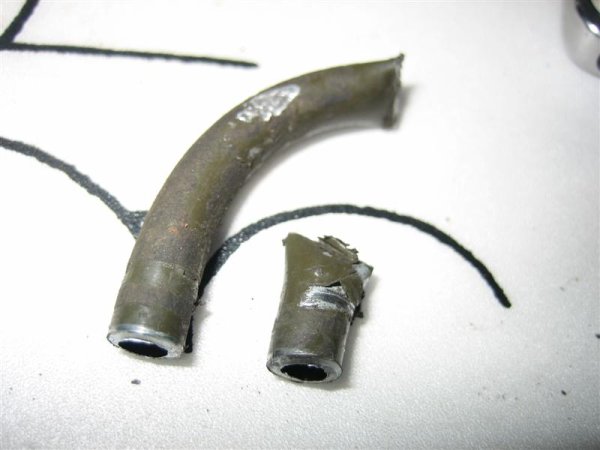

21st Aug 09 at 20:48   View Garage View User's Profile U2U Member Reply With Quote
Oh and that pipe I cut underneath -
Vents fuel vapour to the carbon filter at rear near fuel tank
Ste
21st Aug 09 at 20:56   View Garage View User's Profile U2U Member Reply With Quote
In that case, just get a short length of rubber hose and join it back together. Won't need jubilees as it is only vapour.

21st Aug 09 at 22:05   View Garage View User's Profile U2U Member Reply With Quote
Its on a bend though, no harm using them anyway is there?
