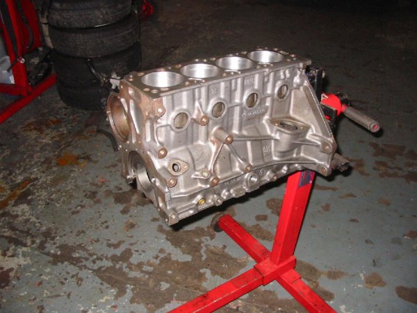

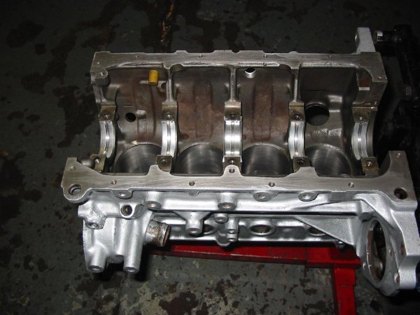

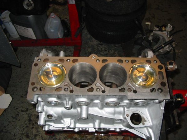

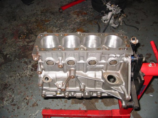

Sent the block away to get 87mm rebore, decked, crank regrind, balance, dipped clean. New core plugs etc, basically wanted it to look Brand New.

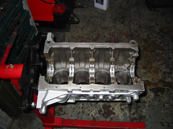

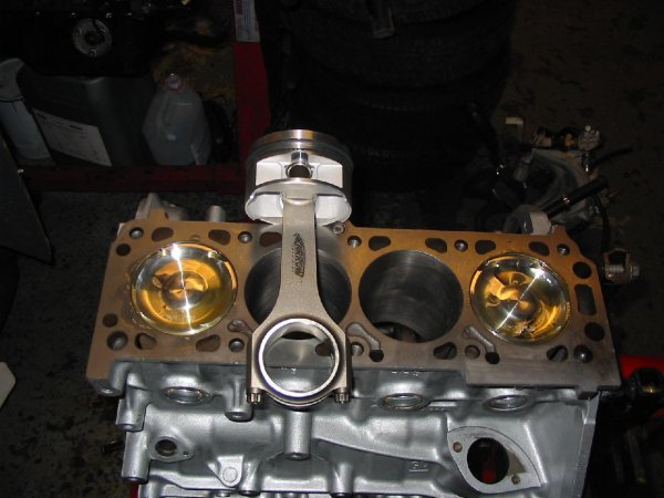

Pistons and rods find their new home

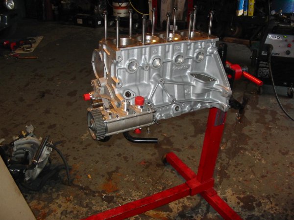

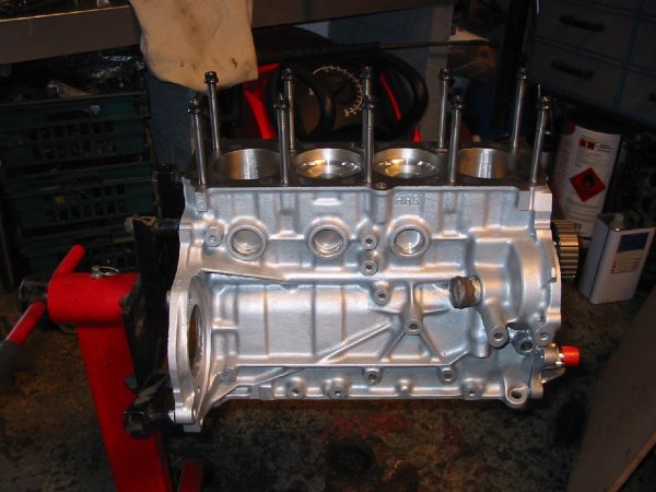

Head studs.

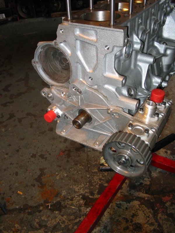

Pace Dry sump bits bolted on, few bits need changing but thats all sorted now.

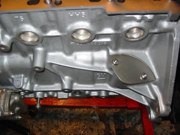

Won't be needing the dip stick so nice little plate goes where the stick use to be

how come you wont need a dipstick? (havent really read the thred tbh)
Nick-S
Registered: 3rd Mar 04
31st May 08 at 23:13   View User's Profile U2U Member Reply With Quote
dry sumped, wont have a sump, will have an oil tank and extrarnal pump
