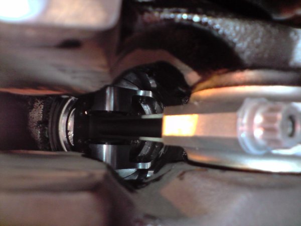

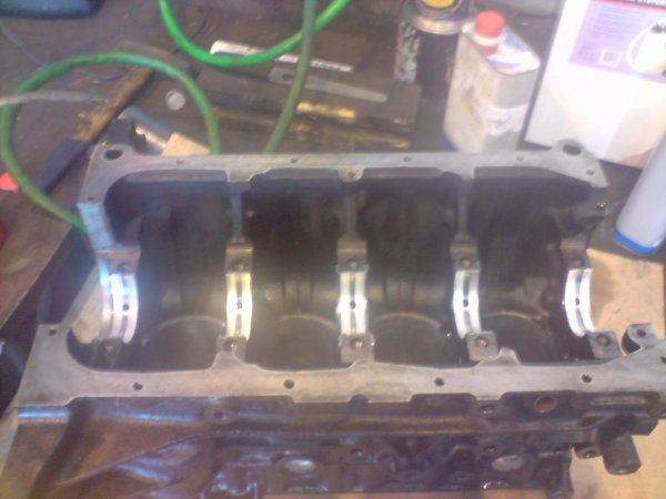

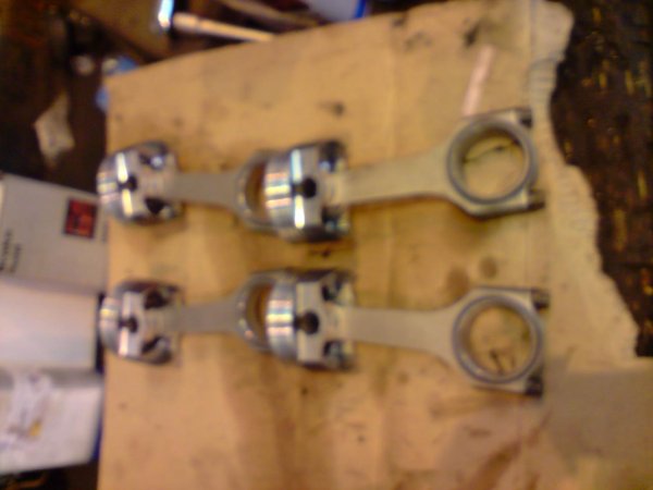

Right, Ill do one big update with pics and delete them other posts....

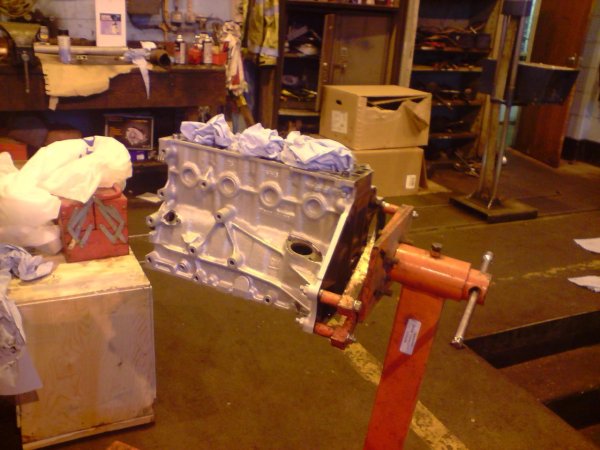

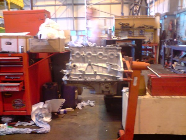

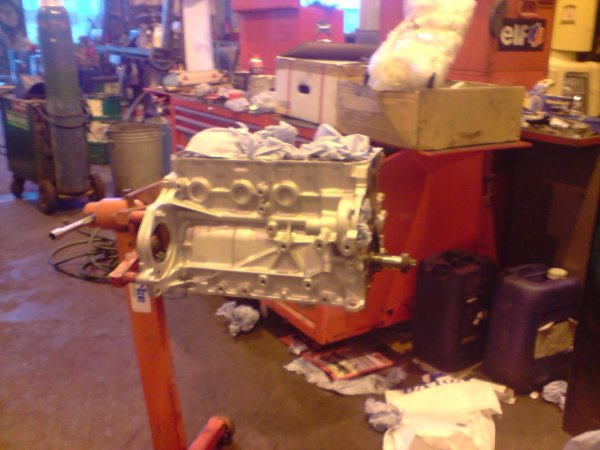

Went and picked the block up from the rebore.

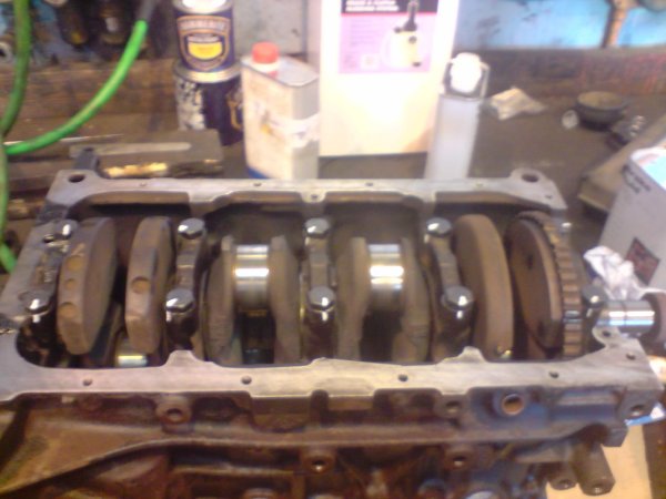

Washed it out again to double check no swarf left from the rebore
Fitted the new main bearings, fitted the crank and main caps (torqued up)

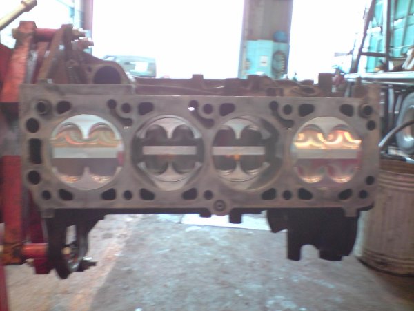

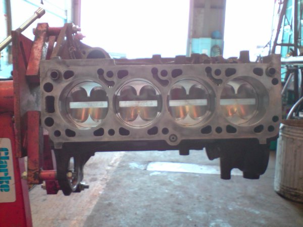

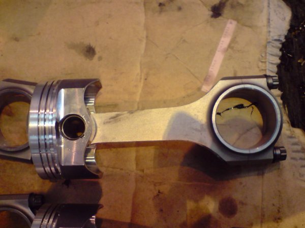

Fitted the pistons to the rods, gudgeon pins and circlips all in and double checked to be fitted correct.
Piston rings fitted to all pistons.
Head face and sump faces all cleaned up.

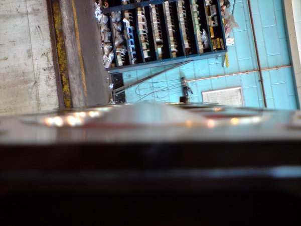

I then fitted the pistons..
Up skirt pic..
Protrusion to make up compression from valve cut outs....
Then finally i cleaned up the block and painted it silver.
Now awaiting an arp head kit, and some new oil pump bolts, then i can get the oil pump and sump on, along with the head etc...

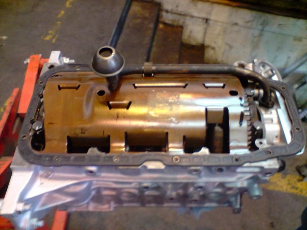

UPDATE:

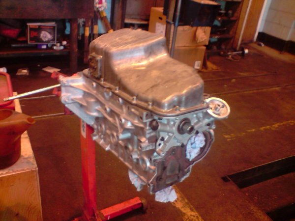

Got dan to run me over the box of bits he had from the engine when i stripped it..
Before i started it, i gave a quick course on health and safety at work, regarding heights and changing bulbs. i decided this was the safest way to go about it....

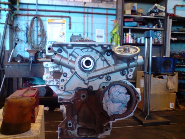

I then fitted the oil pump, gasket and crank spacer ring, along with new front crank seal.
Then i cleaned up the sump and pick up pipe, and fitted those with new stainless bolts along with the new gasket. While i was there i also cut of the level sensor wiring.
Then i spun it the right way up, for one last photo...
I belive dan has just ordered a set of undercut arp head studs and a set of arp flywheel bolts. Those should be here weds morning, and i can get the head fitted.

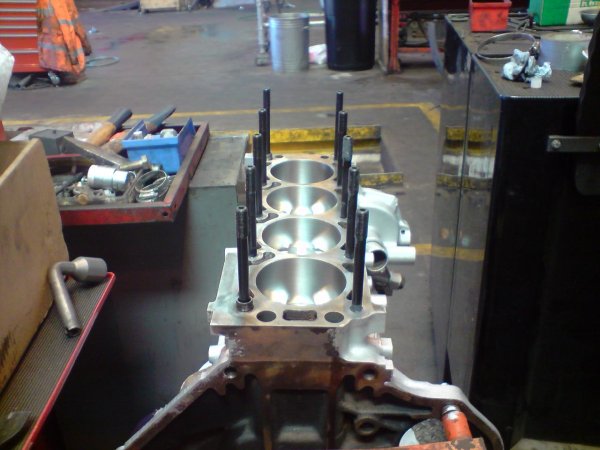

25th Jul 08 at 16:42   View Garage View User's Profile U2U Member Reply With Quote

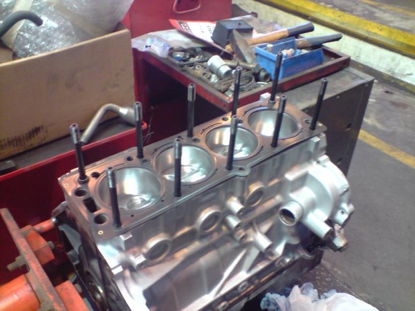

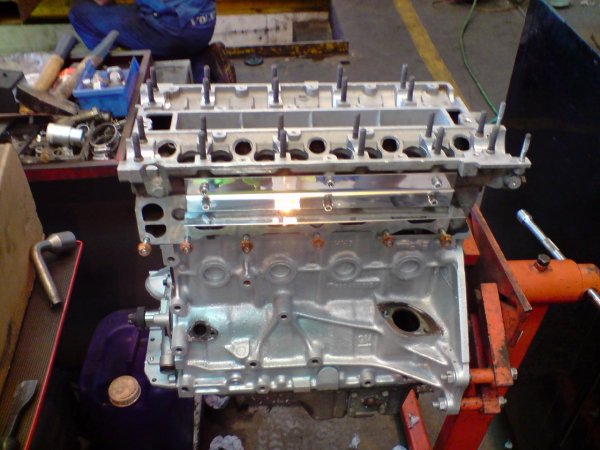

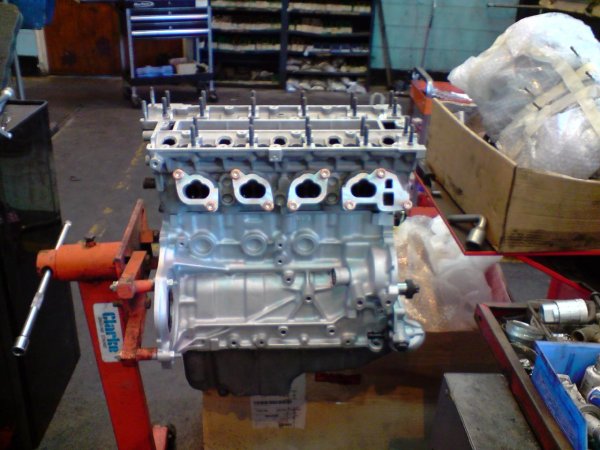

Update :

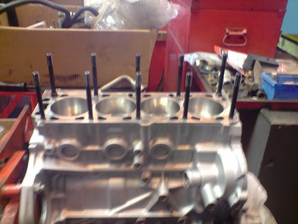

Dan ran the head bolts and head over to me, and i got on with fitting them.
Bolts in
Gasket on
Head on
Heat shield on

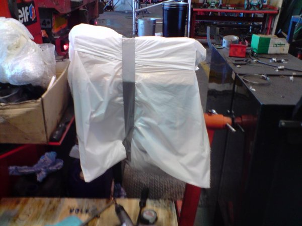

Then the bit i looked forward to the most, packing it away, so its dust free while im on holdiay for the next two weeks!!!

are those head studs in upside down?
Doldy
Registered: 13th Mar 08
Location: Norwich
25th Jul 08 at 22:02   View User's Profile U2U Member Reply With Quote
Nah dont think they are... are they?
Got the hex hole at the top? (top on the above pics that is)
