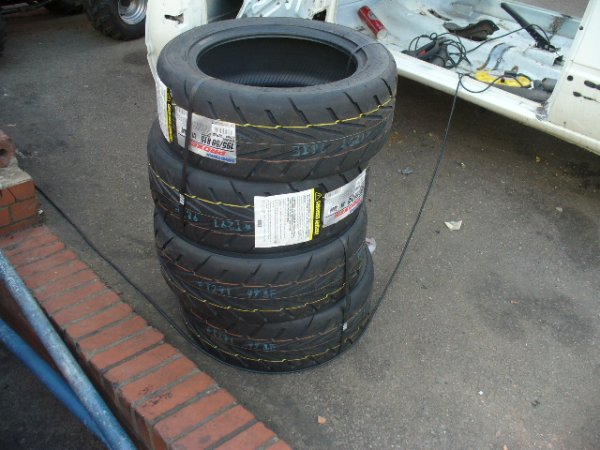

Yeah man. Organised the tyre swapping for later today, so I'll be getting my first experience of more power, with brand new toyo r888s..... in the wet
Launch control should be wired up tonight too, and the car will be stripped out inside to give me an unfair advantage.
