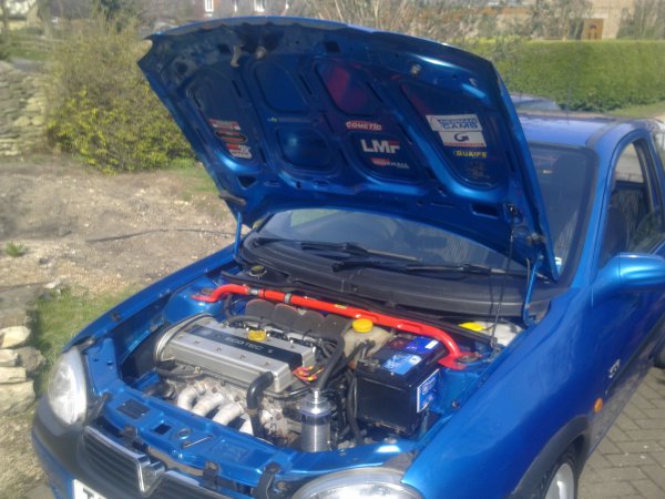

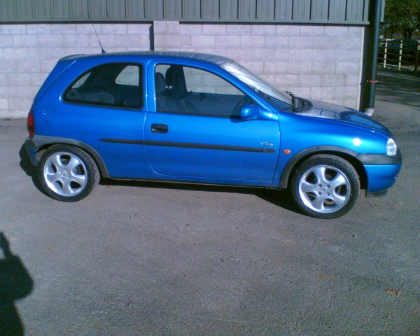

due to heavy body rust ive decided to break my ex feature car, massive spec engine, 226bhp dyno proven x20xev, bilstien coil overs, disc braked rear axle, doors, bonnet, boot with spoiler, interior trim, bumpers, lights.
sensible offers only please and all parts collected or local delivery could be arranged. I do travel to Nottingham some times as well.

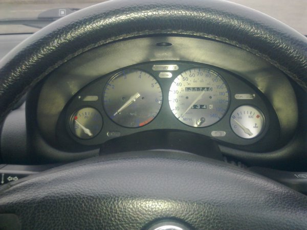

Originally posted by tomfinn94
how much for clocks posted
£2k
clocks go with engine as they are set up to ecu and different wiring now for shift light and others relocated.
rev counter turns red from 7 to 8 k when shift light comes on.

Engine
X20XEV (ECOTEC) from 1995 Vauxhall Cavalier GLS.
1998 cc bottom end, skimmed cylinder block rebored to 87mm with Cosworth 12:1 high compression pistons, Saenz con rods, ARP rod bolts, ARP main bearing bolts, genuine Vauxhall oil pump, Mocal 16 row oil cooler, under piston oil jets in crank case, lightened and balanced crank shaft, light weight balanced flywheel, alloy crank pulley, Piper Cross air filter socks, Jenvey 45mm direct to head throttle bodies, 60mm Jenvey ram pipes, Astra VXR fuel injectors, Glencoe adjustable fuel pressure regulator, Sytec up rated fuel pump, 3.4 bar fuel pressure, Kentcams EC2002 278* road/rally camshafts, Kentcams adjustable cam pulleys, Kent hydraulic cam followers, Kentcams up rated valve springs, Kentcams titianium valve caps, reworked cylinder head ported and gas flowed by Cosworth, matched inlet and exhaust ports to manifolds, LMF Z20LET Phenolic inlet manifold gasket, Elring steel head gasket, genuine Vauxhall cylinder head bolts, Denso Iridium spark plugs, Magnecor plug leads, Etech alloy oil catch tank, K&N crank case breather filter, Lexmaul stainless alloy exhaust manifold and down pipe, DEI exhaust wrap, 200cpi sports cat, custom made exhaust system 50mm bore, Scorpion Imola rear silencer, Mtech off side engine mount and rear engine mount spacer, DTA S40PRO ECU custom rolling road mapped by Stealth Racing UK Ltd.
226 bhp @ 7052 rpm
172 lb ft @ 6068 rpm
7500 rpm rev limit

Suspension
Bilstein coil over height adjustable kit front and rear, front lowered 40mm approx, rear lowered 30mm approx, standard anti roll bars front and rear, OMP front strut brace, and standard electric power assisted steering.
Ronal Soft Star 16” Alloys
Pirelli PZero Nero 195/45 ZR 16 84W tyres.

Originally posted by Josh.Bob
Damn would have loved the clocks?
contact metal monkey's or LMF standard stainless steel faces are around £120 these cost me £150 as they are custom made.
