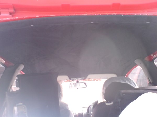

Daniel_Corsa
Registered: 21st Apr 04
Location: Wigton, Cumbria
15th Jul 12 at 20:22   View Garage View User's Profile U2U Member Reply With Quote
Mine...

Here's a pic of mine when i had just fitted it
Cream leather to match the seats/dash etc. Used heat resistant spray adhesive.
The way i did it (and i'm no expert, but this is just how i did mine) was lay the material over the headlining and trim edges to necessary size/fitment leaving a small amount to fold over. Then fold in half and apply adhesive to both surfaces as per instructions (alternating lines and allowing to go tacky) then fold material back over being careful to place it properly and start smoothing out applying pressure from the centre to the edges. Then repeat the process for the other side. Flip it over and trim/glue the edges of material over the edges of the headliner. Sorted. I'd advise having someone help you as maneuvering that amount of material to where it needs to be glued can be quite tricky.

17th Jul 12 at 21:54   View Garage View User's Profile U2U Member Reply With Quote
Daniels old one

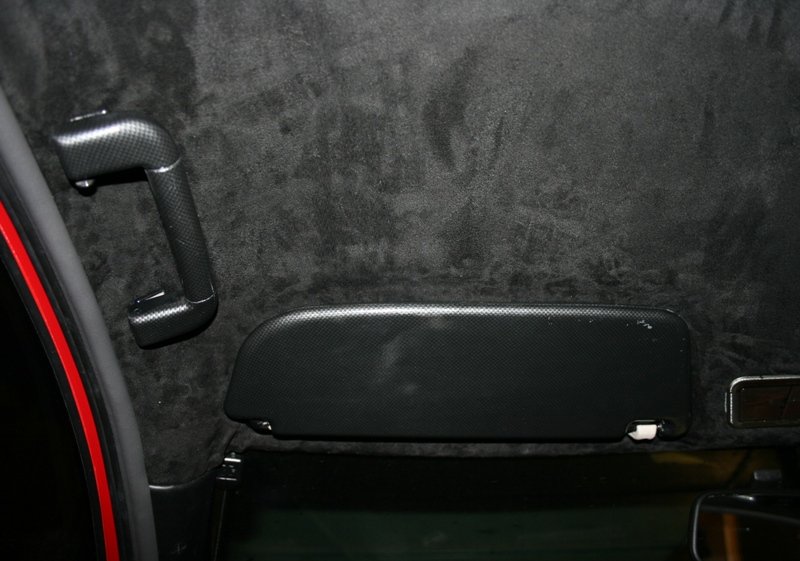

What material is that dan? Looks to be black suede but I'm wondering exactly what it is. Alcantara? Eco suede? Dunhelm nu suede?

Not a headliner but here's a speedo surround I just trimmed for a 206
Mk3 golf gti headlining trimmed in black Eco suede
