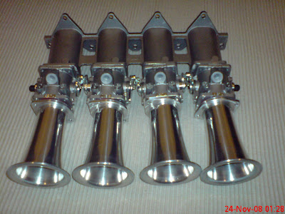

Here is a diagram of typical constant flow velocity through a plain pipe and a bellmouth pipe (the correct term for the pipe mentioned in the original post), the colour spectrum represents the rate of air flow where blue is static, up to red, which is maximum flow velocity.
Plain pipe end -
Belmouth pipe
You can clearly see the bellmouth pipe flows much more efficiently with very little turbulence. The plain pipe demonstrates a flow deficiency around the diameter of the pipe and thus creating a much less efficient air tract.
You see this kind of design used on a typical ITB setup like so -
High performance turbocharged engines use a similar design too -
If you are doing this for an assignment or similar in which it sounds very much like you are judging by the question you asked, I suggest researching "velocity stacks"
