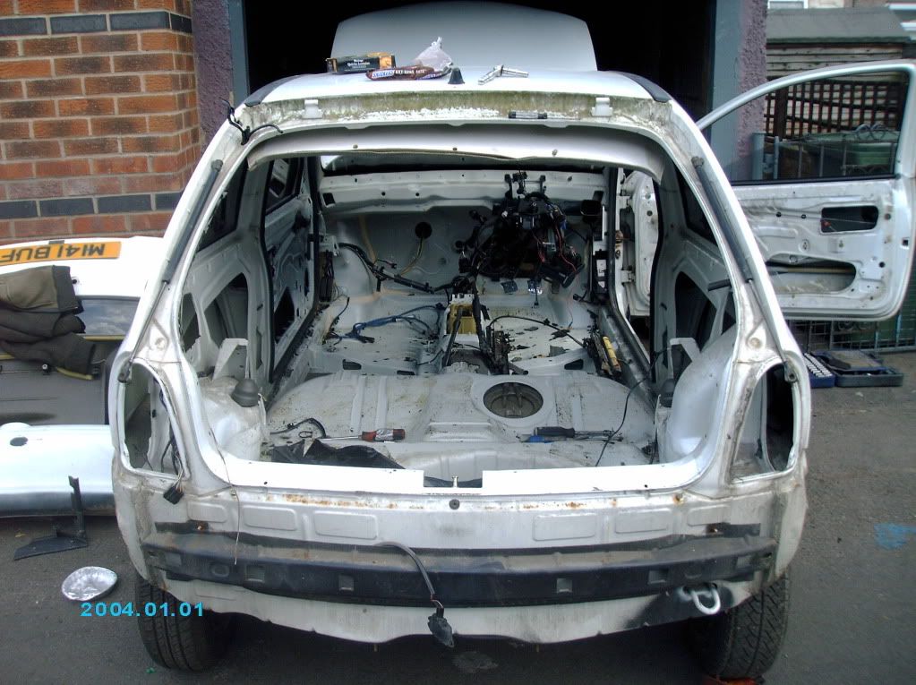

just thought id say hi been reading on here for a while but not realy posted ony thing here is a few pics of my project corsa plans are to put a 2.0l xev turbo in it but for now im just putting a 1.8 ecotec in it till i mangae to get the turbo engine built plz let me no what you all think the date on pics is wrong as couldnt be boverd setting the date on the camra lol
this is it when i started stripping it out

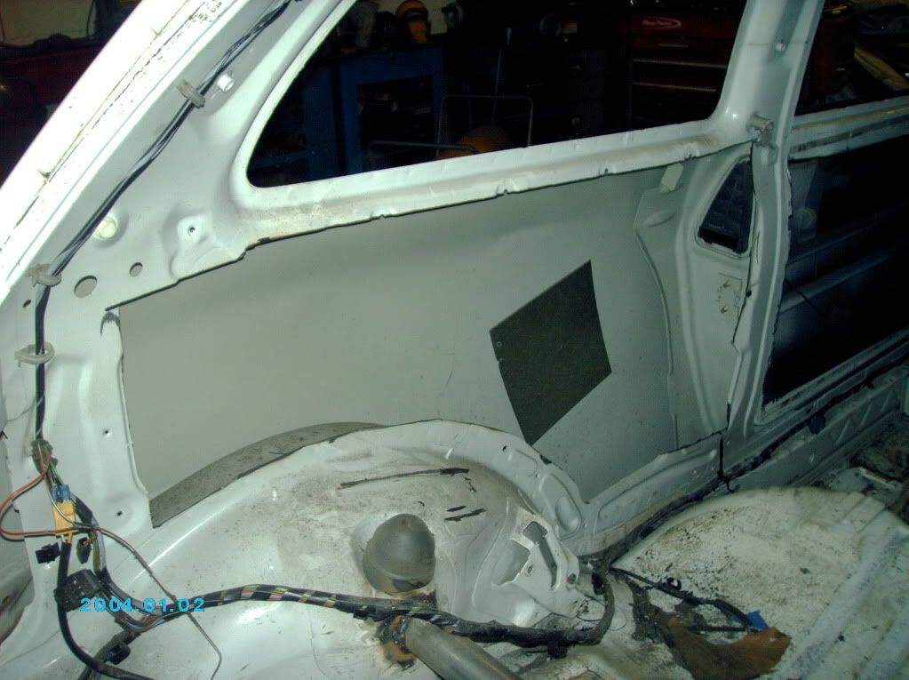

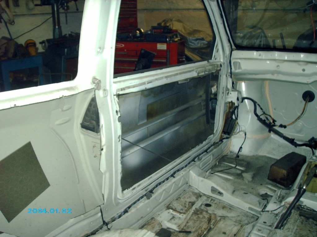

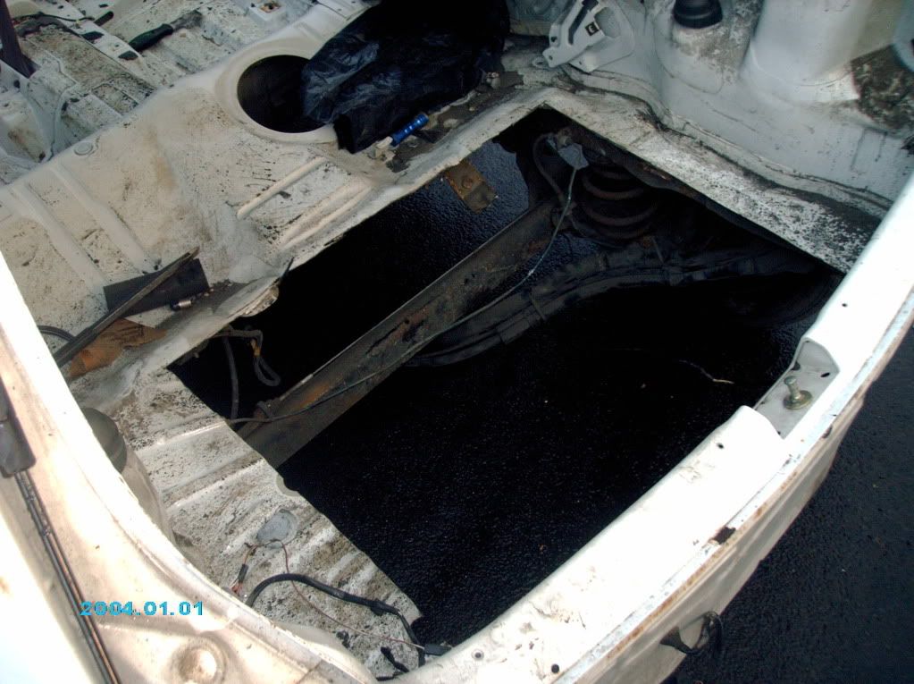

then i started cutting bits out to get the weight down

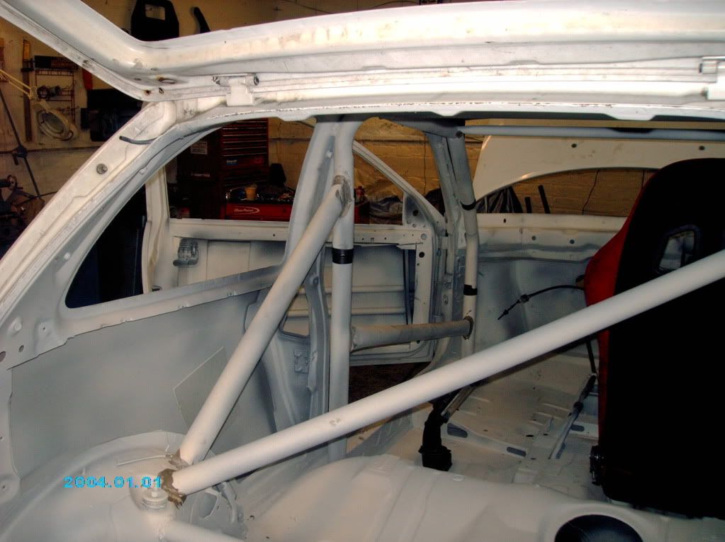

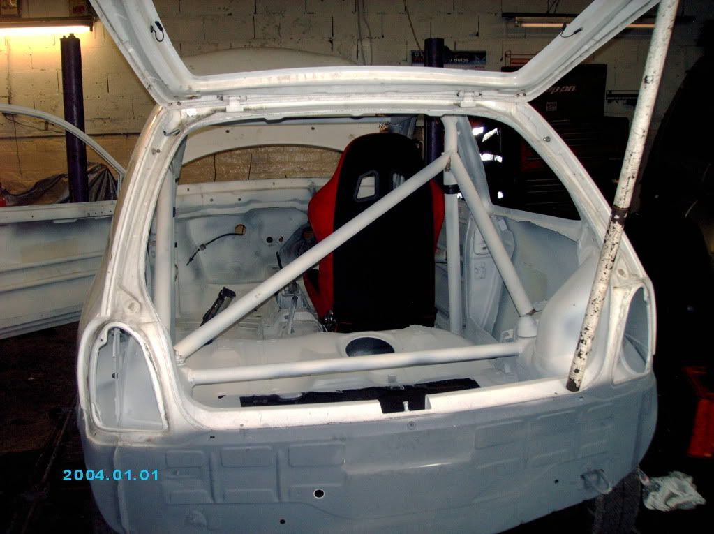

then i built the roll cage
then got it sprayed and started to fit bits in to it
then i fitted the seats and sort of fitted the bottom end

is it safe to cut that much out the door? im guessin your gonna have perspex windows? cause theres no where to mount glass.

thats not the steering wheel thats staying on it only put thet on it to steer it in and out off garrage and colom is getting changed should be safe with that much cut out of the doors as it has the standad door bars in it plus the side bars on the roll cage yes its having poly windows

yes i did mate its not the best out there but it is the first one ive done seem very strong and looks good i think

the origonal door bars are where all the wieght is in the standard doors, personally would have removed them and maybe got a better designed roll cage fitted
the battery would be better at the rear to help wieght distroburion aswell imo

What's wrong with that cage? Looks fine to me as long as the guy's handy enough with the welder. Obviously a wee bit dodgy if it's not certified or anything but as long as it passes an MOT I'd say it's sound.

cage has good welds on it should pass mot as the cage dont get tested
a_j_mair --- why say a better designed cage what can you see thats wrong with mine coz it all looks ok to me and ive gone over it loads to make sure but its the first one i built

Though the only discrepancy I can see is the rollcage, only if you intend going on track days where they need FIA approved cage and what not. Other than that as long as welds are ok it's doing the job

The main hoop looks weak as fuck, and you've flatened the end of the door bars so they are pointless and to be honest theres more chance that that cage would be the REASON you die in an accident.
