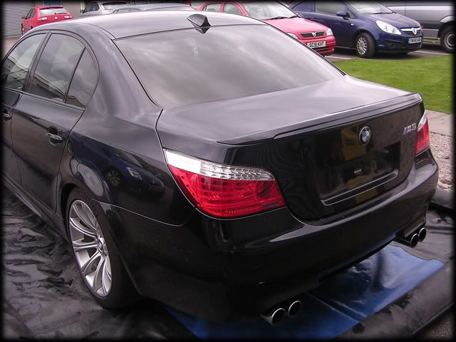

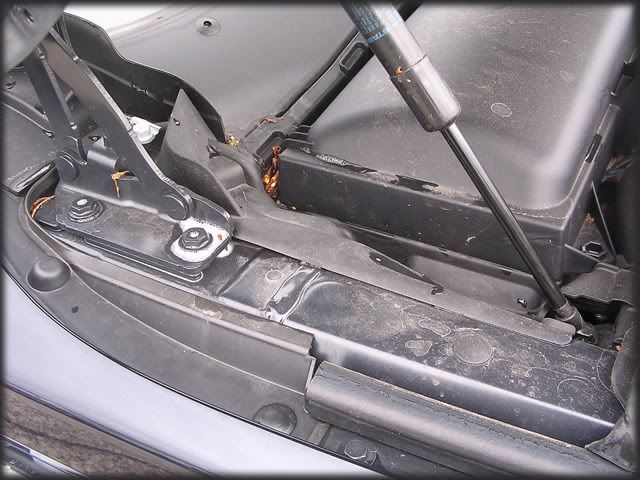

Another new contract start for this M5, in for a 3 day correction:
The car itself is kept pretty clean but there was polish residue from the dealers all over the place:

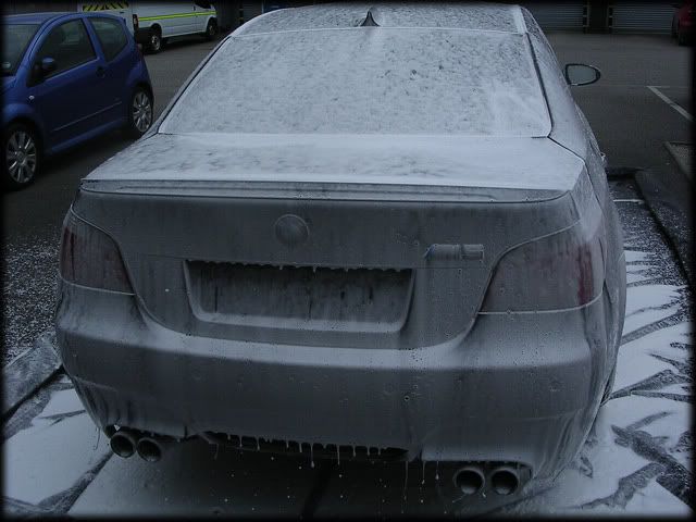

Hot pre-foam was done with R222:
This was left for 5 mins and then rinsed off at high pressure:

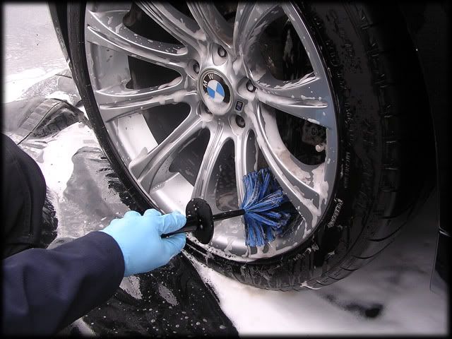

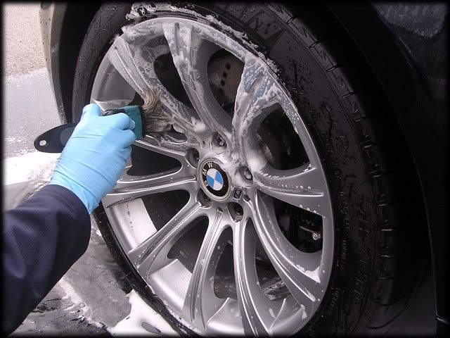

Wheels were cleaned with Gloss-It wheel gel and the various brushes:

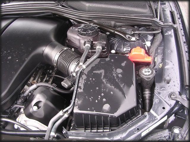

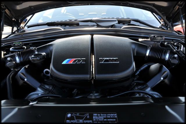

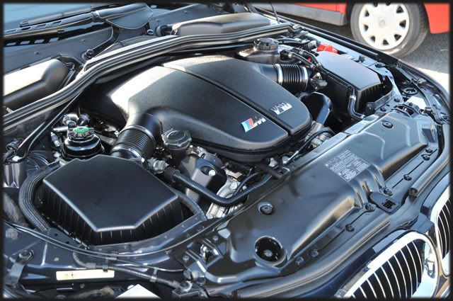

The arches/tyres/shuts etc were cleaned with Meguiars Super Degreaser, as was the engine bay:
After being rinsed off at medium pressure and 40 degrees:

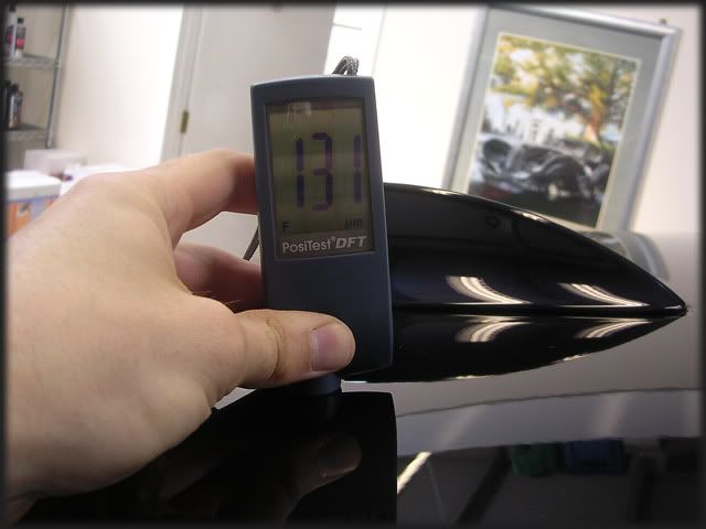

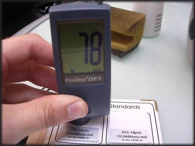

Once dried off I checked the paint gauges were reading accurately...
...and then took some readings, with everything showing nice original levels:

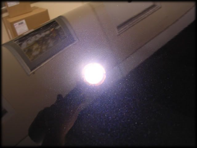

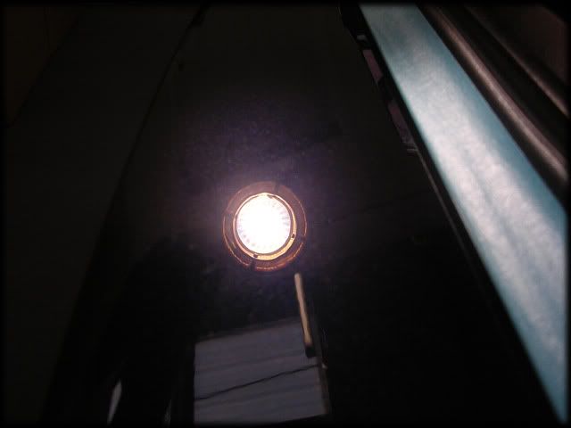

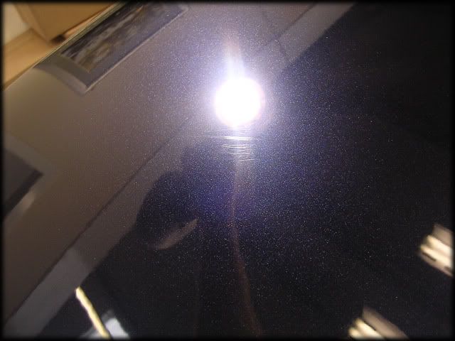

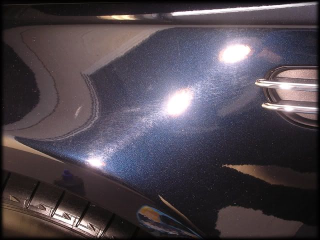

I always find this particular BMW colour doesn’t always show the full extent of defects in pics due to the flake pop so it was difficult to show the true condition but hopefully these couple of pics give you an idea:

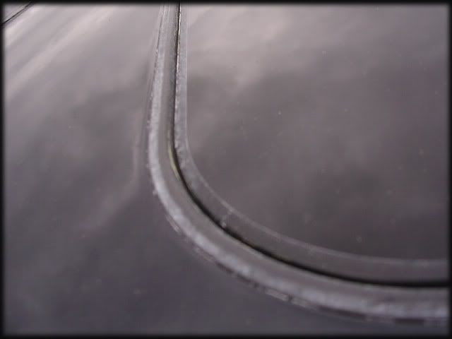

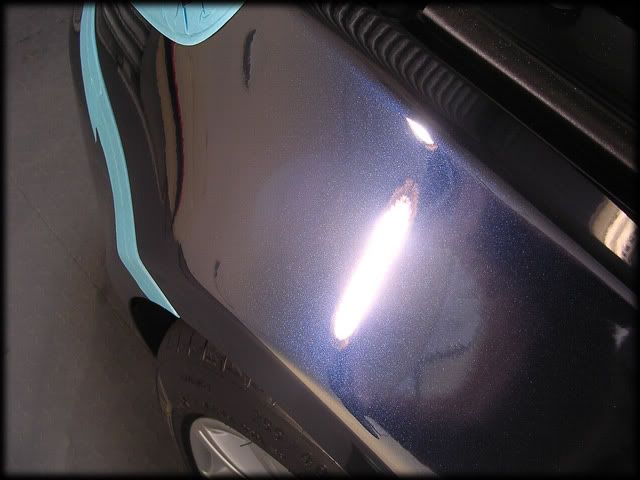

Swirling and marring was minimal really but every panel had the odd random scratch or scuff which would need more than a 1 step polish to rectify.

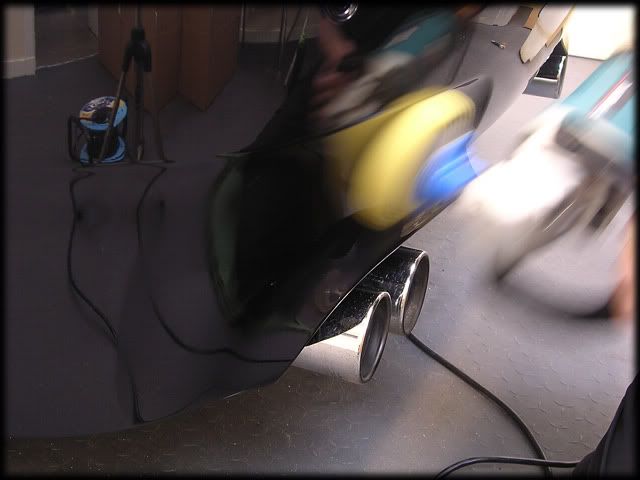

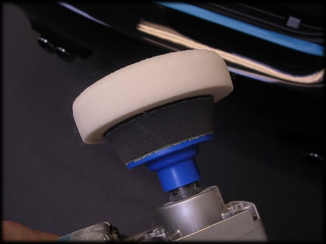

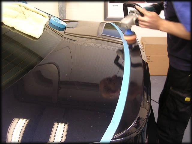

Washer jets were popped out so I could machine in tight to them:

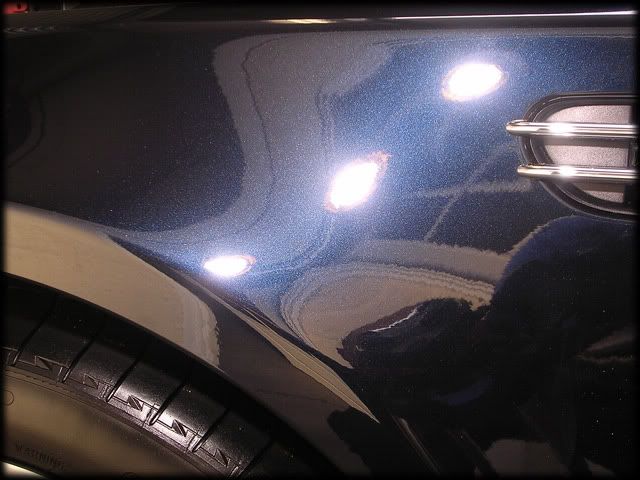

After a quick play of polish and pad combinations I settled on Gloss-It Extreme Cut and a Menzerna Polishing Pad with a drop of EVP Prime:
Being aware of how big the car was and still not 100% sure if I was going to bother doing a write up on this car I didn’t take a great deal of pics during the detail from here but I got a couple of before and afters just in case
Before:
After:

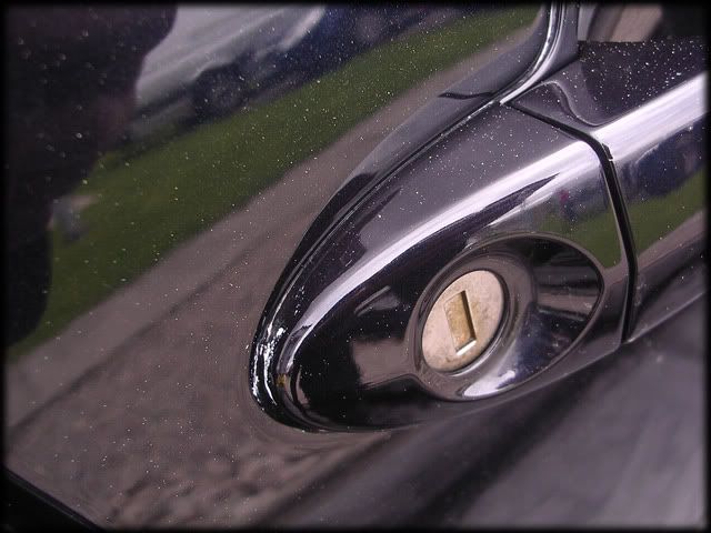

The boot lid had a pretty deep scratch from where a bird crap had been wiped away:
Normal foam polishing didn’t make a great improvement so I used a Gloss-It wool pad and backing plate:
After foam polishing:
After 2 hits with the wool pad (no refining of the finish yet):
Just a small trace still visible under the Sun Gun:

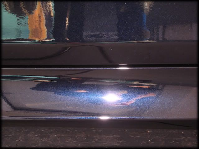

The spoiler was corrected with a Menzerna 80mm Polishing Pad:
Lower section of the doors:

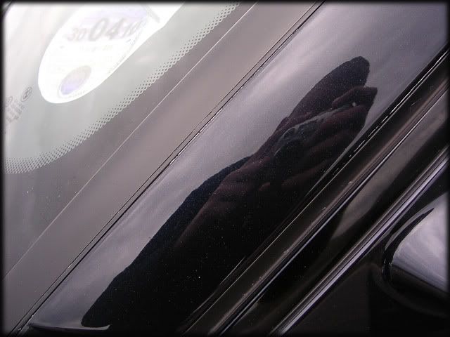

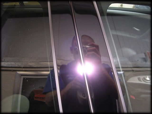

The B-Pillars were also corrected with the 80mm Menz Pad as they had started to weather quite badly:
2 minutes with some 3M Ultrafina and they were as good as new:
Side skirt after:

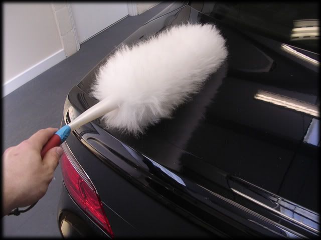

I then dusted the paint down:

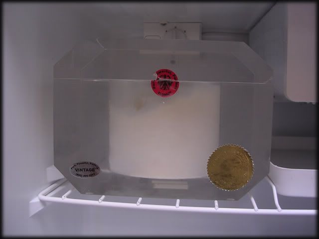

LSP was this:

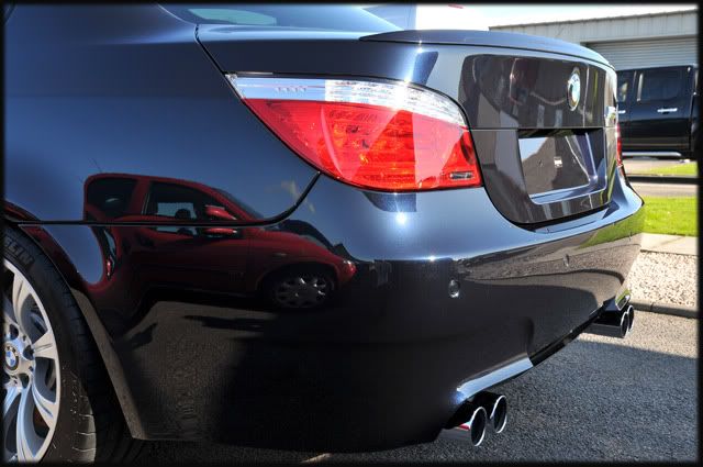

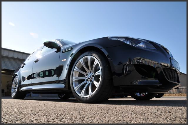

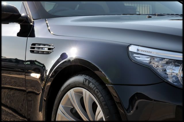

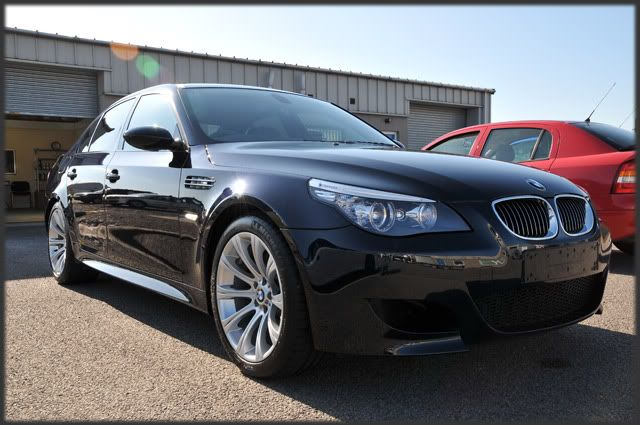

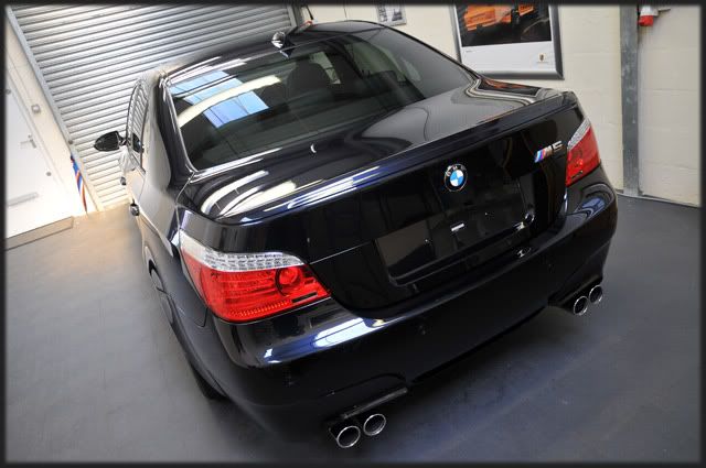

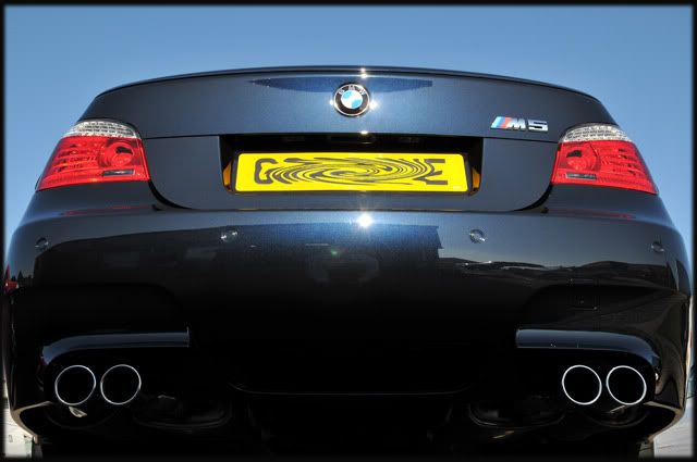

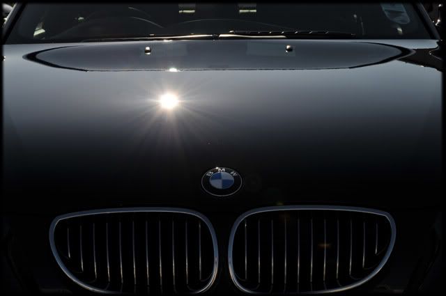

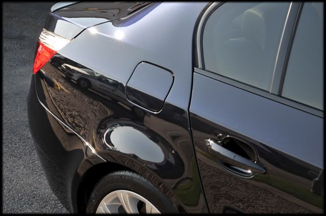

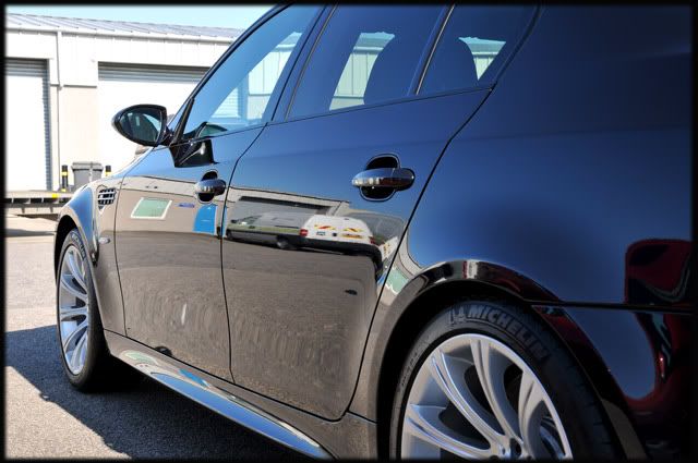

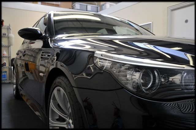

Think that's about it, this is the final result after approx 34 hours of work
