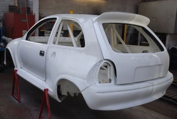

Having read the above, could I have views opinions on this spoiler please...
Lots of Rally Corsa's use it and I was going to get it for mine as I was hoping it would make the backend feel more planted on fast 90/100mph+ corners (Backend has no weight what so ever (Fibreglass tailgate, poly carb windows and stripped)
From what some of you have written above its just going to cause drag???
Its from here:
http://www.eurorallye.co.uk/product_info.php?cPath=8_52&products_id=697
Neil

It is going to cause drag Neil, but I wouldn't worry about that with a 2.0 turbo under your bonnet, unless tops speed runs are your thing That's a classic spoiler, it'll interupt the airflow over the car and cause a high pressure region in front of it, which will act downwards on the flat roof ahead of it. In turn you will have a wake behind the spoiler that will pull the car backwards.
