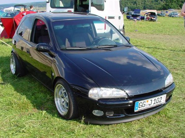

Anyone got any pictures of Corsas with Tigra front ends??? need to convince the GF, did a search but all i got was broken links and missing images

the Tigra is a Corsa Hybrid!

i dont mind the top one
but the alloys make it look a lot worse

How hard is that conversion?? Didn know it was possible!!

I saw it before, and i knew about it, now seeing as my £50 project corsa needs basically a whole front end i thought WHY NOT???

looks kind of like a starlet if u sqwint a little

the green one's a mates..
also got another mate with a pearl white corsa with a tigra front end too
