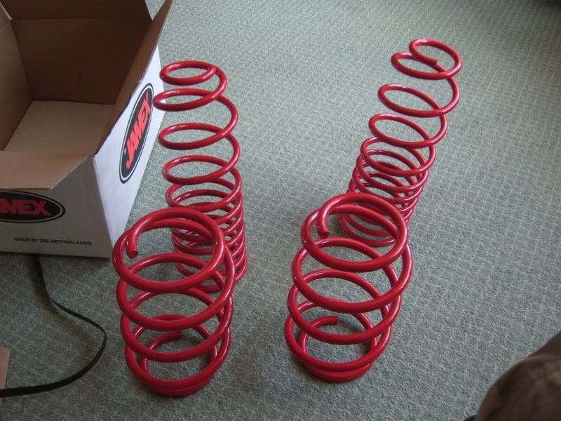

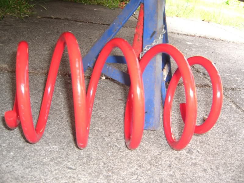

Alright chaps, i got some 60mm lowering springs delivered this morning, bought on the bay.
The rear ones seem abit well big,I tried to fit them but failed missrably as one of my socets have cracked.
Are these really 60mm springs?

im not sure but they look about the same as standard if not a bit bigger
lil_g
Registered: 29th Oct 06
12th Jun 07 at 16:11   View User's Profile U2U Member Reply With Quote
tbh they look like front springs?

lol nah the front springs are bigger
xcore
Registered: 24th May 07
Location: Hampshire
12th Jun 07 at 16:20   View User's Profile U2U Member Reply With Quote
picture of the 4 springs in the kit

that dont look like a kit for a corsa imo

They were not made for the corsa then

nah theyre def not 60mm springs, unless your raising it by 60mm??

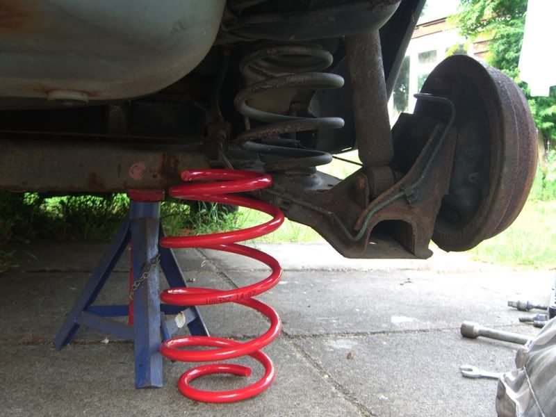

were those axle stands holding the whole back end of the car in the air?
i have 2 on there
whats wrong with that

try getting the rear shock bolt off

12th Jun 07 at 17:19   View User's Profile U2U Member Reply With Quote
hmm that could be why the bolt wasnt coming undone.lol

yeah thats the wrong place for the axle stands as you cant lower the beam to remove the springs, try placing them under the sill piece and use a trolley jack to raise and lower the rear beam, thats how i did mine
